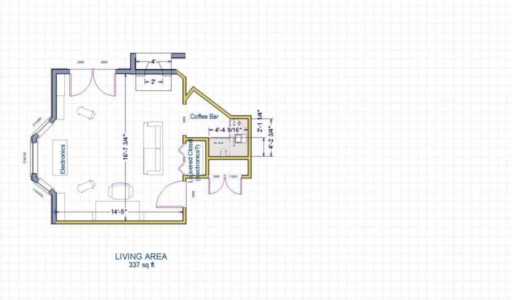

Michael,
The idea of wireless is appealing for its installation simplicity, plus it seems like the latency would not be a big deal at subwoofer frequencies given delay and phase adjustment on most subs.  The traffic pattern in my room is complicated so I'd want to definitely route cables under the floor if I don't go wireless.  While I have access to an unfinished space below most of my listening room, I'd still need to punch 4 holes in the floor and carpet in addition to the floor outlets I'm installing. I still may go this route if wireless proves too daunting.
Here's a plan of my room:
The stack idea is a good one--I'm already planning on having a sub above floor level (although haven't figured out how just yet--one possibility is to put a small sub on the back corner of my desk which is about mid-sidewall).  I'm also considering the 2x15 stack from  Rythmik as 2 of the 4 subs to maybe kill two birds at once.
My thought on the swarm implementation is to have one big mutha sub, 1-2 mid-sized subs, and 1-2 smaller subs.  Some of the subs have adjustable Q which would help with implementing the swarm idea if using identical subs.  I'd pretty much decided on ordering two of the Hsu sealed subs with wireless capability to start and see where it went from there.
Thanks for the great ideas and discussion.
Evan
