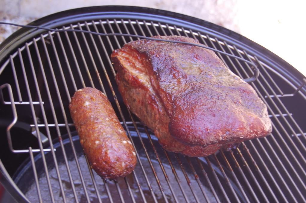

4:00 -- IT = 193 - AT = 250 - 85 ambient - Fattie #2, Japalinos go on.
Ready for the smoker:
I found some frozen Salmon in the freezer, so I threw that on too. Also a couple Japalinos;
A bit later (note the japalinos);

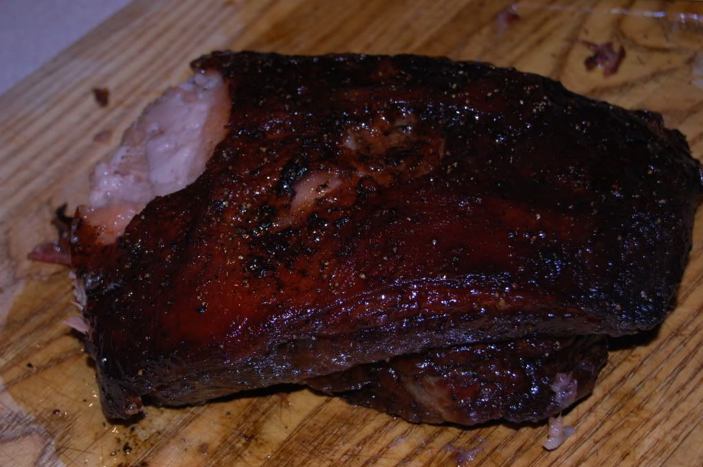

5:00 -- IT = 195 - AT = 245 - Removed brisket (has "butter" like consistency when probed). ** Fattie #2 is on until its internal temp (presently 137) is high enough, or smoker temp gets too low)
5:00..................................... ....Brisket is foiled and put into cooler.

Here's the brisket after having sat in a cooler wrapped in foil for 90 minutes;
