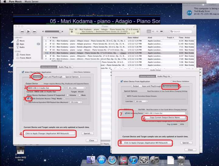

I believe Pure Music outputs a native (non DoP) DSD stream.  If that's correct, then in order for a DAC to play the file, it's either "native" DSD capable, or it performs some type of conversion internally (most likely to DoP).  Is this an accurate understanding?
PM uses DoP (or ASIO if Windows driver allows) which is native.  I helped Rob troubleshoot it.  In the preferences you tell it what the DAC is (i.e it copies the DAC driver info into the DSD section) and then you choose the DoP marker (for example, AAAA or 05FA).  The DAC sees the music, the marker protocol, and away it goes.
The screen grabs from below are older (when PM needed the user to do the copying, which is automagic now) but you'll see the DoP marker radio buttons on the second screen, under "copy current output...."
