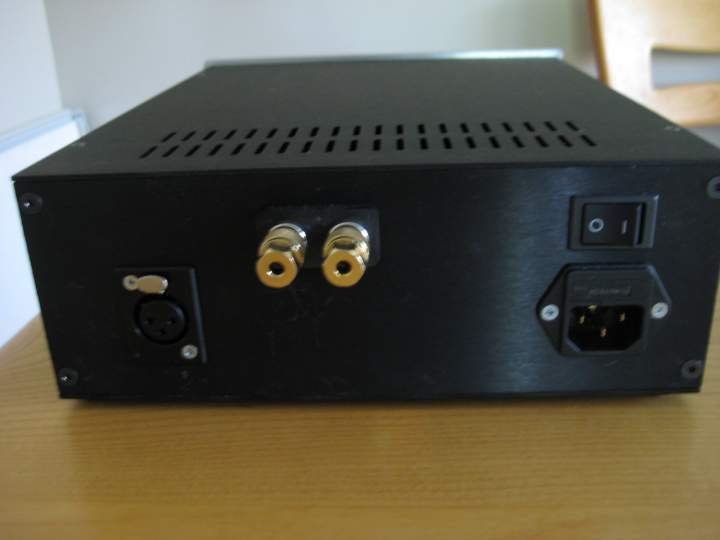

I went with using an iec connector with fuse and a separate NKK switch just above it.  I would recommend a DPST (double pole single throw) switch.  Double pole assures both lines are open when switched off.  This is safer when using balanced power or a incorrectly wired wall outlet.
Can post pics if wanted.
I think in the future I will put a mute switch (using the nampon) on the face of each monoblock in addition to having the mains switch on the back.

bhakti
Re: Power On/Off Solutions
« Reply #9 on: 5 Aug 2012, 03:42 pm »
Here is a pic showing the iec connector with fuse and the separate NKK switch.  Will get the switch details from work next week.
