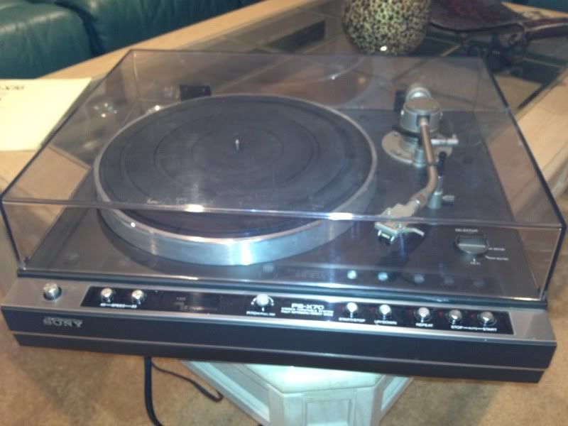

I wanted to upgrade my turntable but couldn't afford a better modern deck. So i found this mint Sony PS-X70 with Yamaha MC-1 cart. I haven't had a moving coil before so i am excited to upgrade on a budget. Should have this in a few days.  :green:

Nice looking deck. I set up a Sony for a friend recently and was impressed by the high quality build. It was heavy and solid.

Thanks Paul, i just got it. I am very pleased, sounds great. But i sure could use a hand getting it fine tuned.  :|

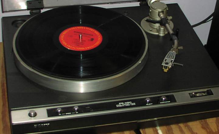

I found that the PS-X50 did benefit from some modeling clay, although not as much as other decks with a hollow wooden plinth. Just be careful to keep it away from the arm mechanism and you might want to give the motor a little breathing room.

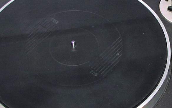

You'll find the owners manual and service manual in the Vinylengine library.  Even if you don't need repair, the service manual will tell you how to adjust the vertical bearings and end of record pick-up point. If you flip your mat upside down, you'll see two overhang alignment grids. The one marked 235 is for your arm.

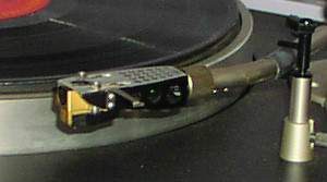

This will give you factory alignment, which is close to Stevenson.  If you wish to change to a Loefgren alignment, it will probably require a headshell with longer slots. My arm is free to align with the power off. The cueing isn't engaged so just remember to use the arm lock if you're moving the table. BTW, the stock headshell weighs 11.4g w/wires. You can reduce the eff mass a few grams with a lighter headshell. This is a modified cheapo shell with longer slots and the front lip ground off - 7.4g.  Cart is AT-15SS.
The arm height adjustment can be used on the fly. After you loosen the wing, just don't let it get away from you.  I have and have owned, much more expensive tables.  I've always liked these Sonys so I picked this up around 5 yrs ago and I'm glad I did. With the right cart, these sound really good, and not just for the money.
