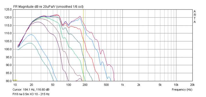

I am also making two 18" subs, for my Magnepan 20.1 extension with a very low xo of 40 or even 30 Hz.
They will be U-shape, with small but evident different shape to avoid cavity noise .
I will use the FI IB318(very similar to AE but even higher linear X max) drivers arriving in two days directly from US.
What do you think, could it work well?

berni
Re: 18 inch Open baffle woofer
« Reply #14 on: 31 Jul 2012, 09:09 am »
First measurements with XO set at 0.5m distance (10, 15, 25, 30,40 75, 145 und 215 Hz) and one measurment on 0,5m and 2m distance with XO set at 30 Hz.
The driver ist still burning in, the Fs is coming down from 28Hz (now 25) , but must go down to 22.
« Last Edit: 5 Aug 2012, 04:48 am by berni »

« Reply #15 on: 16 Jun 2018, 04:53 am »
Any updates please? This is still a relevant topic and the  IB318 in OB SPL's above are impressive.
