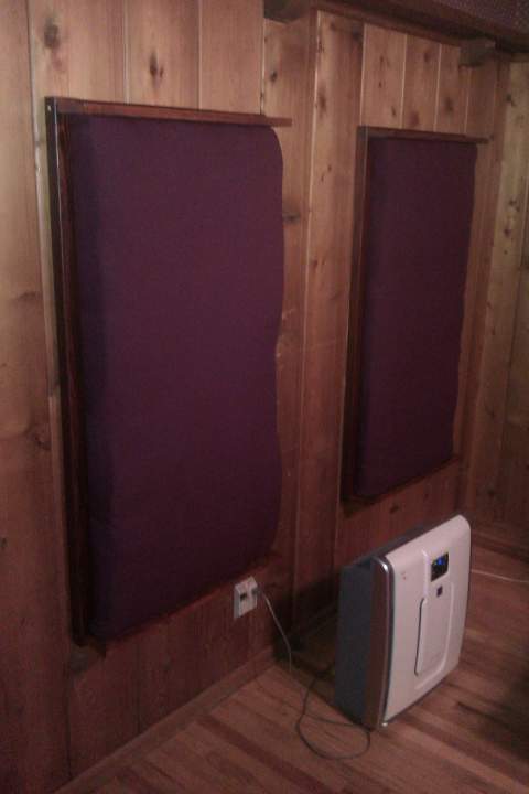

  Those are great looking!  Could you post how you made them?  What's going on in the bottom of the right two?
  Here's a few I'm just about finished with (took pix with phone, they look a lot better in real life), I used rock wool and it turned out pretty lumpy.  Anyone have any ideas how to deal with that?
  I have to make a few more, I think I'll try some photos, great idea.
