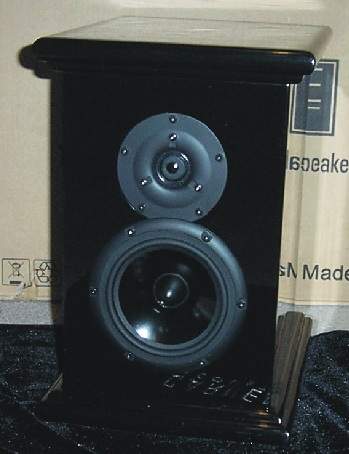

Here is an example. I designed a crossover for one of my clients that had a slight overhanging top plate. The grill fit flush under it and looked nice, but it certainly effected the response.
Here is a pic of the prototype that was sent to me for crossover design.
Here it is after I whacked off the overhanging top.
And here are the measured differences, before and after.
Care to guess which is which?
Imagine if it were closer to the tweeter and even longer. I am guessing that the overhang on the speaker that you sent a link to can cause a 10db or greater swing in the response.
Here is a pic of the prototype that was sent to me for crossover design. Here it is after I whacked off the overhanging top.
From another topic you stated you designed these for another client.  It looks like these speakers would exhibit the same problem.

The comparison you provide is a bit of “apples and oranges”, in that the tweeter you measured vs. the one in the Coherent Plus are completely different.  I’m sure the recessed tweeter is “by design”.  The crossovers are also quite different.  Perhaps you (or I) should ask him about why it is so.

That one has a rounded and stepped top plate rather than a flat one and it's effect is not as bad. Still there are some effects to the response from it being there. With the grills on (which has a radius on the inside edge of the grill) the effect of the top is no worse than the same effect that any speaker grill has on any other speaker.
It's not like having a 3" long flat surface right over the tweeter though.
Diffraction is diffraction there is no changing the physics of it. You can try and compensate for it with the crossover but it doesn't make it go away.
Ask him about it if you like, but I am sure he is not going to provide a response curve with and without it there so that the result can be seen.

Here is a sample pic:
And quite a few people have upgraded from one of the older models to one of the newer ones. Care to guess which line sounds better? I can assure you that the new product line would not have been released if it didn't provide a considerable step up in performance over the older one.
