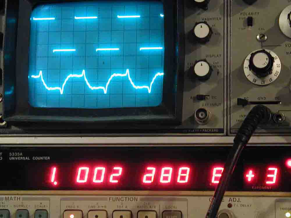

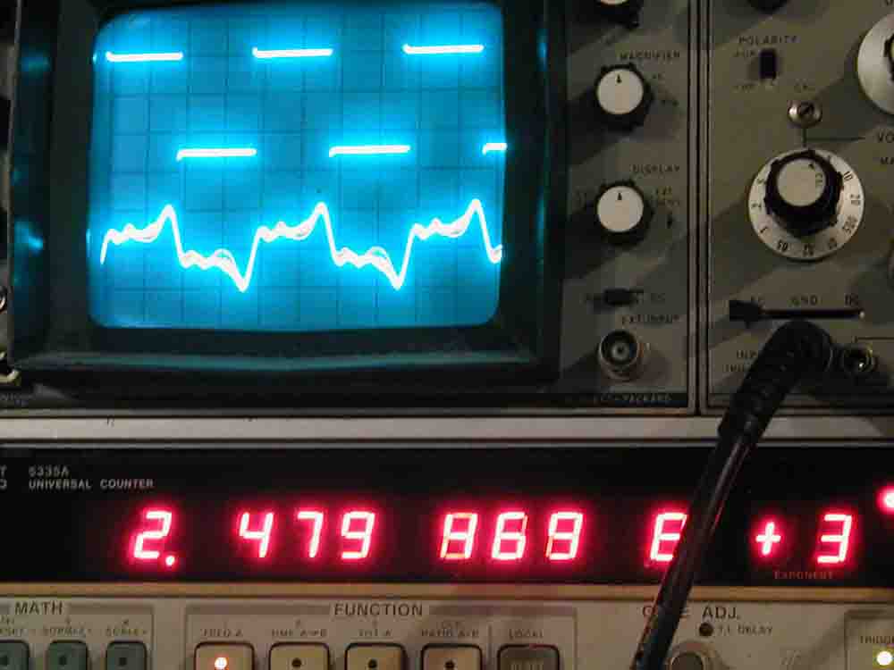

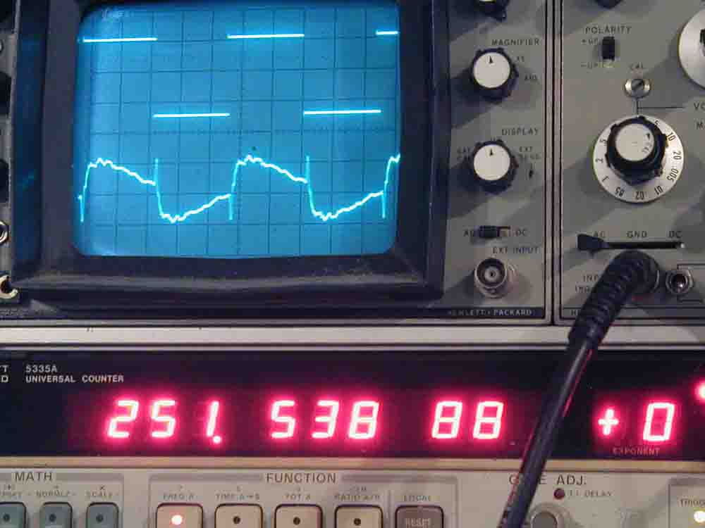

Now I managed to find some square waves ...
Here is the thread:
http://www.diyaudio.com/forums/multi-way/71824-making-square-waves.html#post817215
250 Hz ... I believe this is a SH50
1k
2.5k
The best square wave that I have seen by far, was with an ordinary speaker corrected with DSP (Bodzio Ultimate Eq). It's here:
http://www.bodziosoftware.com.au/Square_Wave.pdf
It starts out as nothing like a square wave. The software is able to dial in an ideal phase and group delay response, so it isn't your average digital crossover like say a Behringer DCX or MiniDSP.

If you have measurements of square waves I'd be interested to see them. It's not something that is often shown.

This is honestly the first time I've heard the idea of a square wave (and its mentioned multiple times actually) so I am wondering if it even is worth using as a tool, to represent how well a speaker sounds. Or is it possibly just one of those things that can look great on paper but have little or nothing to do with the actual sound quality of the speaker.
Danny, have you any input on this square wave reproduction? and do you have any measurements from the N3 or Super V?

Fellows, I haven't seen anyone use an oscyliscope on a speaker in 20 years.
 :lol: :lol: :lol: :lol: typical.  Can't criticize the result, so criticize the tool.
The square wave test is just a visible representation of the phase-coherent nature of a particular design. The degree to which this is audible by itself is hotly debated. Some like Linkwitz claim that the ear is virtually insensitive to phase coherence of this sort. Other anecdotal experience suggests that there is an audible improvement in coherence and intelligibility.
How slight of a shift in phase is really audible is certainly debatable. I have to agree with Linkwitz and many others when one considers listening in a home environment. The total in room response consists of many time delayed artifacts that are secondary reflections, and even reflections that are third and fourth reflections. Even a speaker with a controlled dispersion is not at all immune to these room related effects. This often greatly overrides any slight improvement in on axis phase relationships.
And I have worked with and on speakers that are designed to be time and phase coherent.
Here is one of them: http://gr-research.com/spicatc-50upgrade.aspx
But when it came to all the things that was suppose to be better with a speaker having a near perfect step response, it just wasn't there. My A/V-1 speaker by comparison (side by side A/B comparison) killed it in sound stage and imagining.
It's fairly clear that phase performance is not a make-or-break characteristic since there are many great sounding speakers that aren't phase coherent. The question is whether it's a refinement that elevates an already good speaker even further.
This is true. All most all of the best speakers I can think of are not phase coherent. In fact I am having trouble thinking of a really good speaker that is. So far I have not seen having a speaker that is time and phase coherent to present an advantage. If you were outdoors (no room reflections) and in a fixed sweet spot then maybe so. Place the speakers in a room and forget it.
