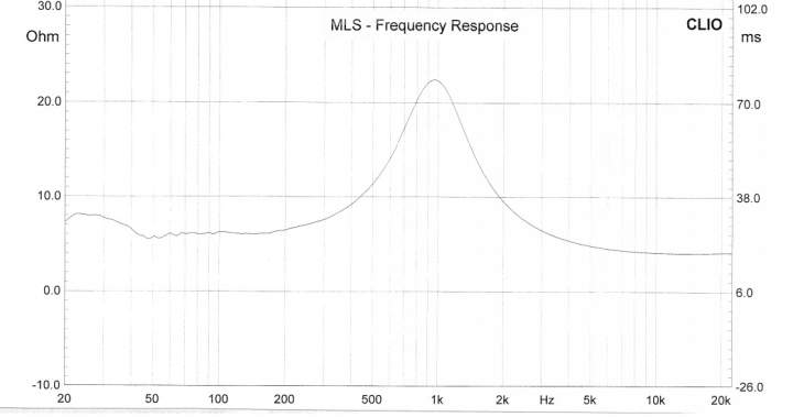

dawnrazor
  • Posts: 14
  • Cutting razor sounding violin
Re: Does anyone have Magnepan MMG measurements?
« Reply #11 on: 12 Jun 2012, 04:09 am »
Crap, you're right.
Could someone with MMGs do a measurement, please?
If I had some they vanished when my hard drive was attacked by a virus.
hey Steve here are the ones you sent me from Wendell.
They were pdf but I made them into picts.  The were a bit mislabeled and still are here.

Congrats on the purchase.  You may find you end up with a touch lower crossover point at the end of the day, depending on your setup and preferences of course.  Mine gets set at 50hz.
And funny with Wendell's FR curves, it's almost exactly what I came up with and I spent forever trying to correct the room's "problems".  Wish I would have known it was in the speaker.
50hz is way too low a crossover frequency for MMG's......IMHO.  They're running out of gas well above that.
More than likely it was a room "problem."  It's very difficult to get meaningful measurements (in room) with a system like the MMG's...at lower frequencies.  Even MLS-based systems can yield confusing results because any kind of meaningful measurements require a long enough time window that the results are no longer anechoic.
I wouldn't read too much into those measurements supplied by Wendell.  The fellas at Magnepan have just as much difficulty with these types of measurements as anyone else.  :)
A completely free-field (outdoors with no boundaries) measurement of the MMG yields a pretty darn smooth response.  As you move down in frequency you see the expected roll-off (these are not full range speakers) but it's still fairly smooth.  This is the only way to get a really good look at the speaker response...by itself.
Any of the new-fangled "room correction" systems are a complete misnomer and a questionable concept to begin with.
If you try integrating a woofer system with the MMG's you may or may not get a smoother response......depending upon woofer type, room placement, crossover frequency and type, electrical time delay added, etc, etc.
Dave.
