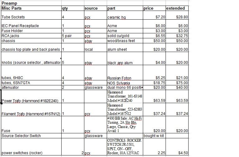

This is going to replace my Anthem Pre-1, a fairly highly regarded mu-follower tube preamp with a separate tube rectified power supply. One day the PT went out and started filling my living room with the smell of burning electronics. I was thinking about attempting to repair the unit, but partsconnexion offered me $275 for it with them covering shipping, so I took that deal since I wanted to build a preamp to match my Simple SE amp (in avatar).
I recently spent about $700 in parts and materials to build this preamp, a bit more than I wanted to spend, but it does include REL PCU copper foil output caps, 2 Hammond trafos, and high end passive parts throughout including Amtrans carbon film and Mills resistors. I bought 4 6H8C Russian tubes for the output and 4 Sylvania 6SN7GTA for the input tubes so I will have spares. I am using 2 mono stepped attenuators with prp 1/2W metal film resistors. These attenuators are a ladder/series hybrid with 66 steps of attenuation, one knob for coarse adjustment, one for fine... so my preamp will have 4 volume knobs and a selector switch, lol.
http://glass-ware.stores.yahoo.net/m1mostat.html
I am building it with dual outputs, the .47uF REL PCU caps for full range, and another set of outs with a 2uF Solen cap for subwoofer output, just in case my subwoofer's amp (now or in the future) has a low input impedance. The .47uF cap has a 4.2Hz corner frequency driving my tube amp, but the freq would be too high for a 10k input plate amp...
Here is a link to the user guide PDF, it's for the 9-pin but most all of the parts are the same for the 6CG7 build. I have the Octal guide, but it is more confusing and has more mistakes than the 9 pin guide.
http://tubecad.com/2009/03/13/Aikido%20All%20in%20One.pdf

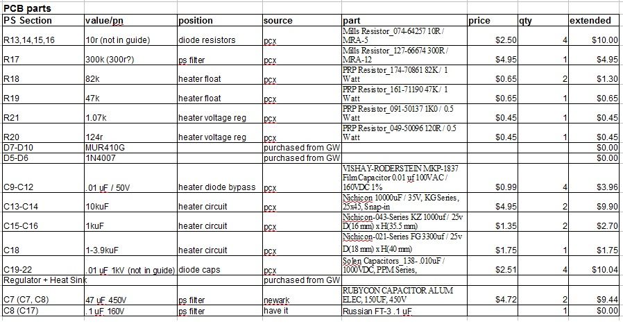

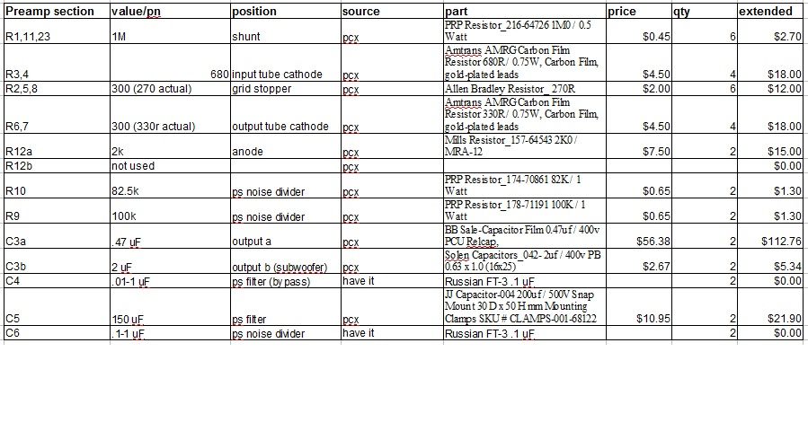

Here is my BOM, please let me know if you have any comments or suggestions:

The tube sockets are PCB-mount, they will be soldered into the top of the PCB, everything else will be bottom mounted so the PCB attaches just below the top surface of the amp chassis and the tubes stick out the top. I am using the all-in-one PCB, I feel this is a great way to go, with a PCB the "wiring" is done for you and tested, chances are it is a better layout that what you can do yourself unless you are an expert in amp wiring and layout. Even then, there is a chance a PCB is going to be better, it depends a lot of different factors.
As for passive parts selection, definitely spend some time learning about the different types of resistors and capacitors used in tube amps, or just buy the PCB with the all the parts included from Broski. I used Mills wirewound non-inductive in the PS, they are the cleanest of resistor types. Carbon comp is best for grid stoppers (I used Allen Bradley), and I prefer a good carbon film directly in the signal path, which includes anode and cathode resistors. I used prp metal film for the attenuators because they aren't as expensive as Riken or Amtrans carbon film. There are higher end than these even, some Vishay bulk foil goes for $10-$15 each, but like the $100+ teflon v-caps they are out of my budget range. I went with REL PCU copper foil output caps mainly because they were on sale for $50 each, down from $100 and get spectacular reviews. For my tastes I think a copper foil cap will be great. I would read some reviews and choose your poison depending on your own tastes and wallet thickness. Price range is $5 to $500 each.
Tube selection should start with gain, decide what gain you need and narrow down your tube choices according to the specs. I have heard many opinions saying Octal is best for SQ, but tube choice is much more limited.

Here's some pics of the progress, I hope to put it all together real soon...
