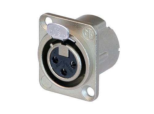

I was starting to assemble the chassis and discovered this.  :scratch:

The Neutrik D chassis XLRs share the same cutout dimensions as the Cardas chassis mount XLRs. at the hypotenuse's endpoints of a 24mm x 19mm right triangle. The Neutrik 'P' chassis mounts have different mounting dimensions.
Is that a Neutrik XLR?  The Neutrik seems to be a bit less rectangular than yours with tighter screw hole spacing.
Steve
jtwrace
  • Posts: 11430
    • TIPP YouTube Channel
Re: CNC mono chassis $71.50ea + shipping Utah
« Reply #166 on: 15 Jul 2012, 05:32 pm »
Steve
His looks like a Radio Shack XLR...

I purchased them from Apex Junior. They are supposed to be the NC3FD-L-B-1. I think the basic hole pattern is the same on all the Neutrik XLR connectors.
Also noticed that Hypex sends flat head machine screw, but the holes in the bottom plate are not counter sunk.
You can't see the stamp on the connector, but it is marked as Neutrik.
This is what I used.  http://www.neutrik.com/en/xlr/dl-series/nc3fd-l-b-1
I'd check those dimensions vs. what you have

The one I have is taller overall (35 mm vs 31 mm). Do you happen to know the thread size for the xlr openning? I'm missing a screw.
For mounting?  3mm

I've got the same cock-eyed twist on my XLR input as well.  Using Cardas CM F XLR (CARDAS-74525) - but I'm going to mount it internally so it will be less noticeable.
And yes, JT is right.  The XLR and IEC use 3mm x.5 and the chassis uses 4mm x .7

« Reply #173 on: 15 Jul 2012, 07:09 pm »
Thanks. I'll probably order new xlr connectors and extra screws from Parts Express. Just want to do things right.  :thumb:

M3 bolts and nuts for the unthreaded Neutrik chassis mount connectors are often difficult to source locally in the States. But it is quite easy to source 4-40 nuts and bolts. When I received my chassis connectors they arrived with no nuts or bolts. So I went to my local ACE franchise hardware store and bought 4-40 stainless steel bolts and brass nuts. They fit perfectly. FWIW

That is a "P" style connector, it appears the holes are drilled for the more common "D" style Neutrik. If one mounts a D style in a cut out for a P style, the connector is skewed in a similar fashion.

I think mgalusha is correct. I need a D connector like theone jtwrace put in his link. Thanks everyone for helping me with this puzzle.

My XLRs are cock eyed too.
I may just leave them for now.
