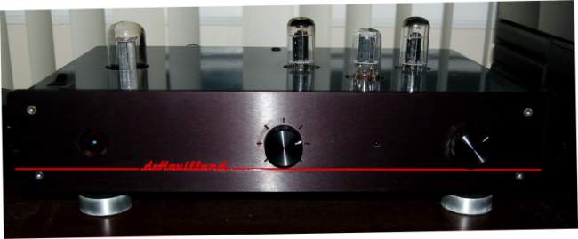

deHavilland UltraVerve 3 Madness
« on: 20 May 2012, 12:38 am »
Ever since I heard an Audio Research LS27 I've been on the quest to locate the perfect preamp.  It had to have a wide and deep soundstage, tremendous detail retrieval, even balance from top to bottom AND it had to be in my price range which makes for a very tall order.
I was using a Sonic Frontiers SFL-2 which I just loved but the die was cast after hearing the ARC pre.  As Diamond Dog said, what you've once heard can not be unheard.
I'll give a real quick rundown of the system in question: VTL 300 DeLuxe monoblocks w/ Winged "C" 6550s, Magnepan 3.7 speakers, Harman Kardon HD7600II CD player used as a transport with an art di/o DAC and a Yaquin tube buffer w/ GE tubes, a Sherwood S3000-III tube tuner, a Well Tempered square motor w/ an Ortofon 2M Black cartridge, a Jolida JD-9 phono stage w/ Sovtek 12AX7-LPS tubes, an APC power conditioner, Kimber 8TC speaker cables, twisted silver interconnects made by the equally twisted owner, the S/PDIF is an inexpensive one from Blue Jeans Cable and the power cords are Supra LoRads that I whipped up.
Enough of the boring crap.
I'd been mildly interested in deHavilland preamps for a long time but it wasn't until I read a few recent threads here on AC that my interest was really rekindled.  One came up at the right price and here it was, at my door.  Happy Day for Funboy here!
I hooked it up and the reviews were right - large and deep soundstage, dead quiet, great detail retrieval, dynamic but a lot of bass which is what I wondered about.

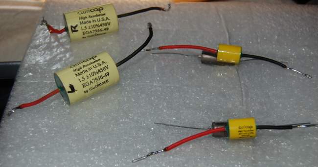

Her idea was to change the coupling caps.
VTL, not surprisingly, did not respond to my email but I found the information in an old Stereopile review and Kara did some calculations and came up with this:
Cap            100hz                 50hz              30hz
.01 uf          -4db                  -8db             -12 db
.02 uf          -1.2db               -4db              -7db
.033 uf        -.7 db                -2 db             -4 db
.047 uf        -.2 db                -1 db             -2 db
and she sent me a care package of caps and some Wonder Solder to give it a whirl.
I only needed to back the bass off like a click or two (if it had tone controls) in order to get it right.
First in were the .033 uf caps and that sounded an awful lot like my old SFL-2 but it was a bit bass-shy.  They came out and the .047s went in and that was much more betterer but still just a bit too much bass.  Picky bastard, aren't I?
Kara suggested running two .022 caps in parallel: one K40 Y9 0.22 Russian and one 0.22 AuriCap and I never argue with a woman as they are usually right.
Pictured are the two 0.22 uf caps alongside the original ones:
It only took a few minutes to install these bad boys
and after 25 minutes or so of warm up, El Perfecto.

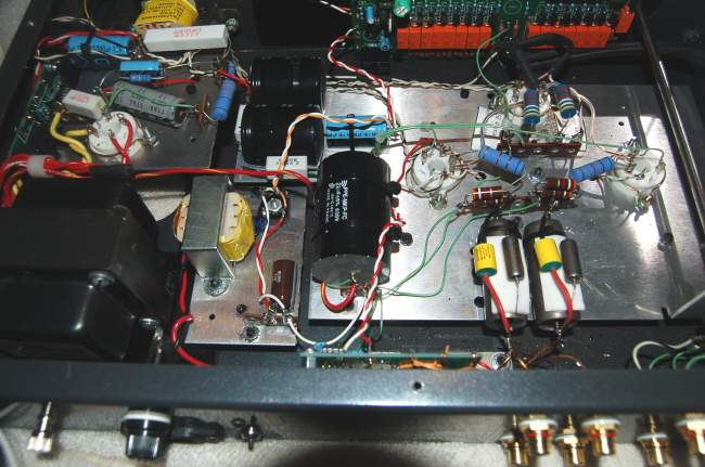

What is that large cap underneath the 0.22 Auricap+0.22 K40Y combo?  Looks like what you are doing is bypassing the large coupling cap (another K40Y?) with 0.22+0.22..
It's always an empiric science with cap mixing and matching, but when it works, it's a beautiful thing.

Here's the answer:
The original caps in the UV were  a 1.0 uF K40Y9 and an Auri 1.5 or 1.8uF in parallel.     Your photo looks like you still have the 1.0uF  K40Y9
connected with the small caps.  If you are in the groove sonically--don't change anything!   What I had intended originally  was to remove both the Auri 1.5 and the K40Y9 1.0 .
I misunderstood her but I'm in the groove sonically so I shall take her advice and keep my fat little fingers to myself.

So much for keeping my fat little fingers to myself...
I ended up with too little bass so out came the two pair of .22 uF caps and in went a pair of .47 uF AuriCaps which got the balance just right.
The bass is healthy but not overwhelming for me and the mids and highs are right where they should be.

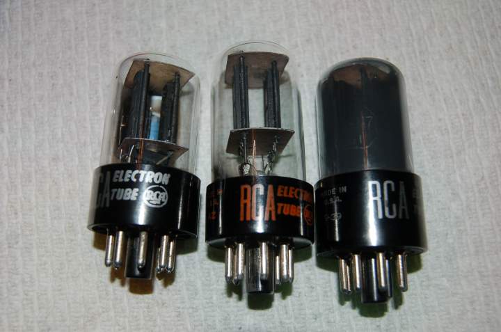

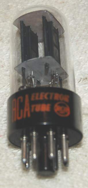

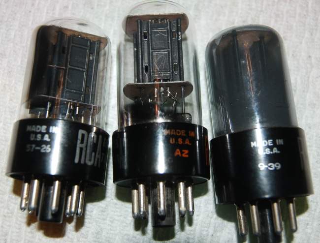

For the 6SN7, I've settled on The Big Three:
Far left with the silver lettering is one from the 60s which was a gift from MediumJim, the orange lettering in the center came with the preamp and I'm told is from the 1970s and the smoked RCA on the right is yet another gift from MediumJim and "is from 1949 and came out of my 1950 Gibson GA30 guitar amp" and was too good for the amp according to him.
All three tubes sound rather similar but I think that the orange lettering comes out on top by a nose.
That concludes my thrilling review on this preamp and thank you to Kara Chaffee for her helpfulness, MediumJim for the great gift of tubes and the people here on AC who pushed me off of the fence and got me to buy this piece.
