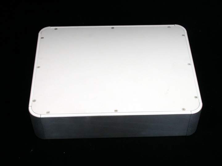

Does anyone know if there's a group buy in the works?
This one looks good also:
And I noticed this one has a Bamboo front panel option:
