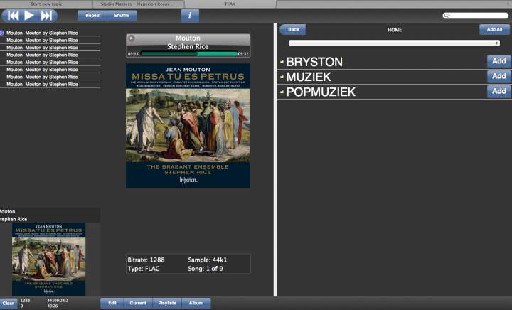

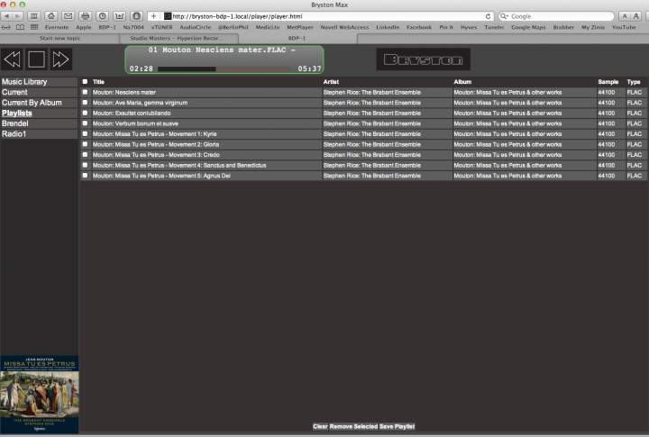

Hi,
Having dl'd some of these recordings at hyperion http://www.hyperion-records.co.uk/dp.asp?dp=1020&vw=dc, how can I see whether they are Hires? BDP1 and Max display only 44.1 hz as sample rate. No 16 or 24 bit displayed. Bitrate is higher then with redbook alright, but shouldn't/couldn't there be a visible 16 or 24 bit display somehow?
Max
and Max2

Hi Marius,
I realize it may not be vary obvious but check the lower left corner for 44100:24:2

Bingo!
Thanks Chris. the :2 is for stereo? (getting ready for multichannel?)
Still, there's no way of checking the resolution of tracks on the BDp1? 24 or 16 bit 44.1 files all lighting the 44.1 led  only. Maybe a sign in the front panel display would be possible?

Bitrate of redbook is 1411kbps uncompressed. FLAC bitrate will vary because of the compression involved. In reality, it doesn't mean a lot - after processing the full 1411kbps stream is available.
Looks no different to your standard cd compressed to flac to me, based on those screenshots. More than likely 16 bit I'd say
P.S. http://www.hyperion-records.co.uk/downloadPP.asp?vw=dc - Almost definitely 16 bit. So exactly the same as redbook.

HI Adprom,
these http://www.hyperion-records.co.uk/dp.asp?dp=1020&vw=dc are 24 bit recordings as stated on the website StudioMasters. the Mouton displayed in my screenshot is one of them. BDP1/Max2 says so too...
Their regular flac downloads are 16 bit alright.
Correct and no we have no plans for more then two channels for the BDP-1 as the Juli@ card only handles two channels...... i believe.  The output is provided by mpd.
