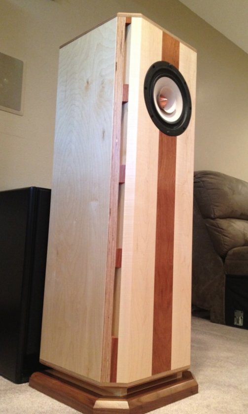

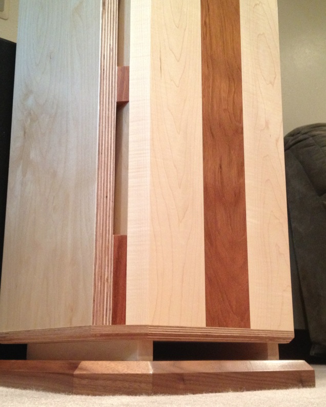

Cool build Jon, nice work.  It appears you have glued a piece of lumber between two pieces of plywood, are there no concerns with the lumber shrinking and swelling or did you use some type of joint that would allow the lumber to move?

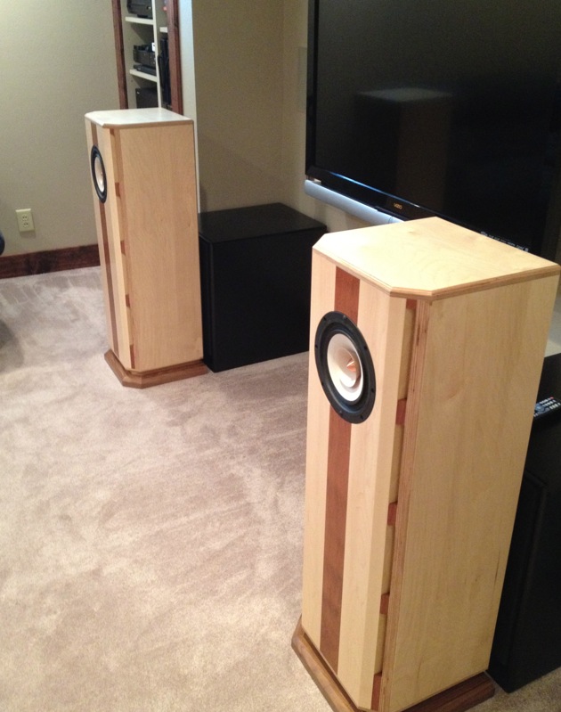

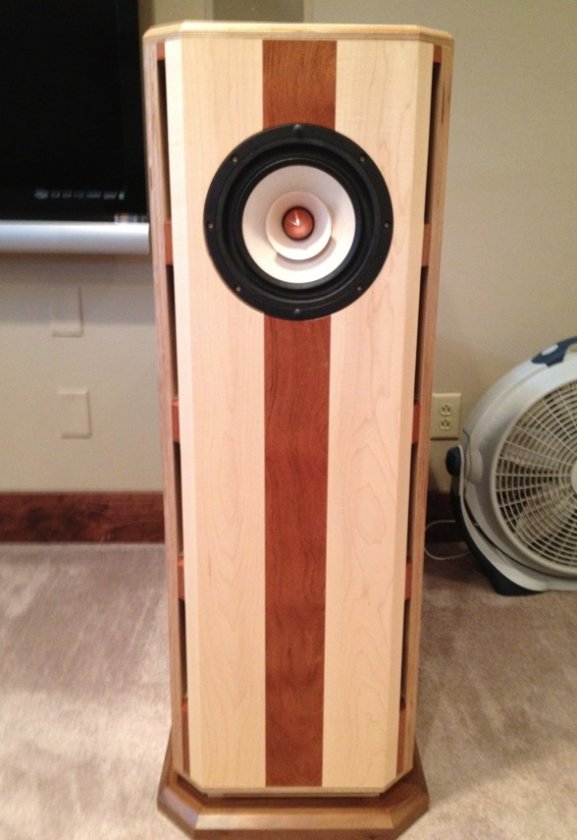

Ed.  We will see. The wood is all grained the same way and I did use screws where I could hide them and of course lots of glue.  I should be ok in a regular household setting. Big left outside??????  Separation may occur. Fronts are maple sandwiching Brazillian cherry, Baltic Birch sides and back with walnut bases.  Full pictures to come tonight.

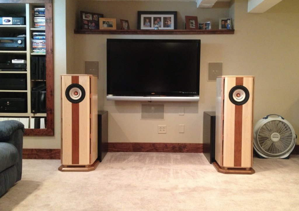

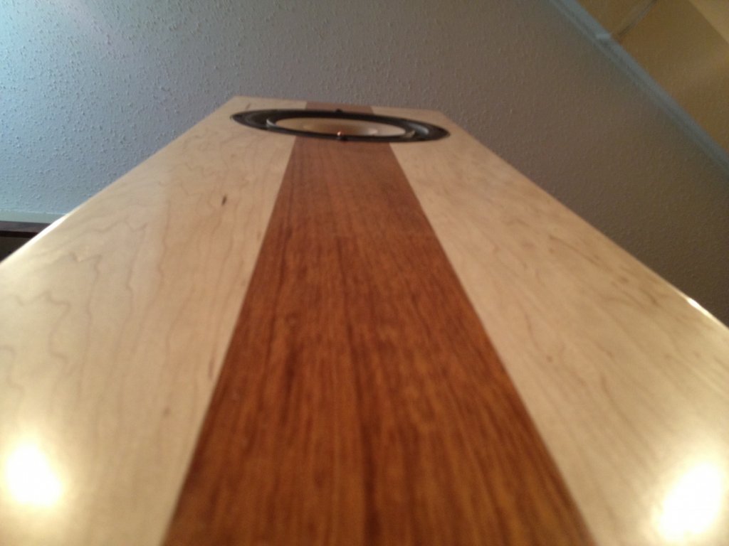

Clear shellac and the two coats of water based satin clear.  Sanding between all coats and letting dry fully.

Listening to the Stereophile Test CD number 2, and Ave Maria by Schubert sounds wonderful. The imaging is spot on, there is a tiny sizzle at the top that needs to be corrected, the violins sound as if they are playing in front of you. Current system is spouting out of an Apple Airport Express 44/16 in to a Virtue 1.2 with regular psu of 15 watts, generic wire all around and separated by 10 feet- slight inward pitch.

Just to see what would happen, I have loaded the top three port holes on both sides with high density rubber foam floor pad.  I wanted to see what would happen to the bass good or bad.
I'll let you know...
