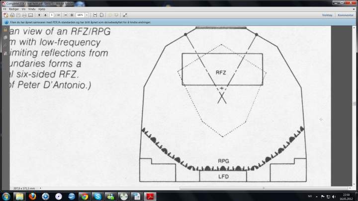

2) Ideally diffusion should start about above the schroeder frequency (where the modes start in the room) and diffuse up to around 5khz. Diffusion above that is debatable, but it does have the advantage of removing flutter-echo and you avoid potential high gain reflections above the diffusion range. So Diffractals are nice if you can afford them.
3) Our ears are on the side and we are more sensitive to sound arriving laterally. We also want to have a boost of energy arriving from behind as long as it's arriving after a certain time. It not only brings liveliness and is preferable, but it's also an important psycoacoustic cue related to accuracy. 1D diffusors will remain more energy since they aren't sending diffusion vertically.
4) A minimum of 5 would be great. Placement depends on room layout, distance to listening position, etc. One could either cover most of the backwall in ear height and some on rear sidewalls or redirect the energy on backwall with a splaying wall/gobo and have every diffusor on rear sidewalls. One could also make a large circle of diffusion if the room is very wide, which is seen in the picture below. RPG are the diffusors.

No need to use diffusors on the ceiling at all unless it's a sloping ceiling sending specular reflections back to the listener.

So the recommendation is absorption in front of the listener and diffusion behind?
Bjorn
Re: Diffusion vs absorption? My set up
« Reply #17 on: 17 May 2012, 06:57 am »
Yes, but very generally said. More spesific would be to say that one treats early reflections with either absorption or redirection and later arriving reflections from behind with diffusion if the distance permits it. One needs to take note that absorption should only be used at those spots that create early reflections in sweetspot. We don't want to use absorption (and especially not thin panels) unecessarily which can easily leave the room dead and dry. The goal is to create an RFZ (reflection free zone) and that can also be done by redirecting the reflections to the rear of the room where they will eventually be diffused. In most cases for instances, provided the rear of the room is properly treated, there's seldom a need to absorp high frequencied behind the speakers. Most speakers don't backfire high frequencies. Bass absorption is crucial though behind them. To find out exactly what do to, measuring and utilizing ETC is the key.
