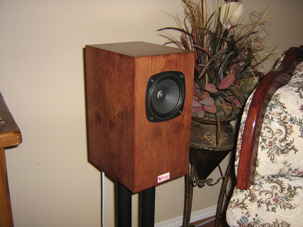

We put our HA FR4.5 into Brynn (BVR), would also work in Gabriel. I know of at least one set of Fonken sporting FR4.5 as well.
dave
« Last Edit: 14 Apr 2012, 08:08 pm by planet10 »

I was looking at the Brynn earlier today. Looks doable and nicely sized for my small room as well. Dave, any thoights on moving the driver off center on the baffle?
I think I'll try them in these first if they fit in the hole.

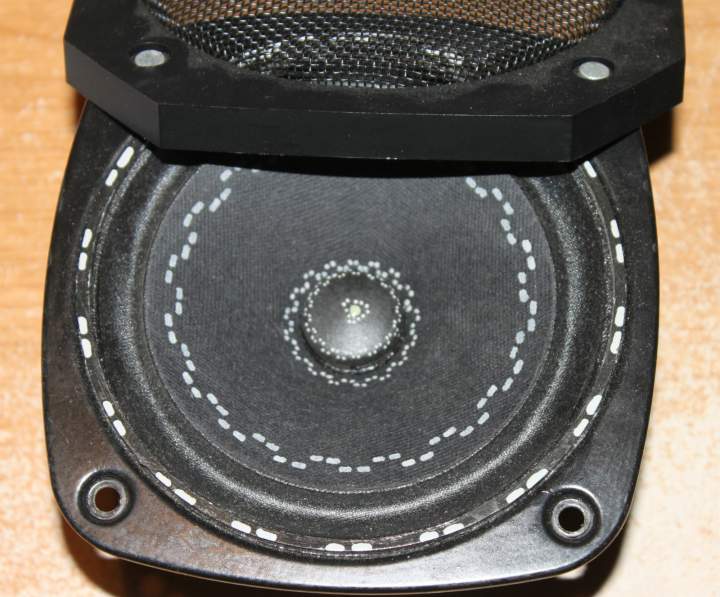

The Hemps have had a little treatment done to them. Not sure it's correct, but they should be fun to play with.
I don't think that bang in the middle is the best place for the driver, officially they are offset vertically by the golden ratio.
IIRC a slight increase in hole and a detailing of the rebate ... long time since we worked with them.
Standard EnABL1 set... they are well done, looks like they could use gloss. And maybe a midcone ring-set.

Nice to know the dots were done correctly.
I obviously didn't look very close at the drawing Dave. I think I'll give the Brynn's a go.
