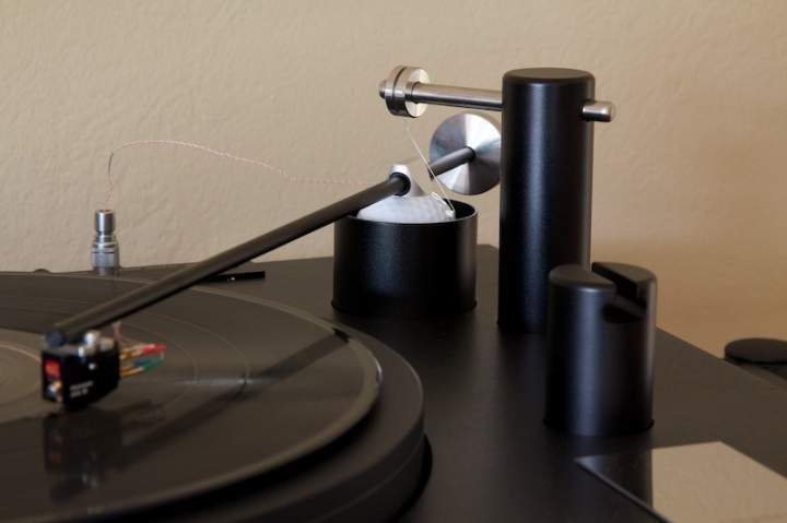

I am now a new Amadeus owner! Have been learning a bit today, patience is key. In the past month I added the new Phono pre(Nova Phonomena) and just a few weeks ago a huge addition, the Dynavector xx2 mkII based on this forum. That cartridge is a great step up from my Ortofon 2M black.
   I was expecting the same kind of leap after getting the WTA. I recieved it yesterday and started spinning this morning. Underwhelmed at first, reading all I have read, I know this will take a bit of time. Noticed a bit of wobble in the platter, posted here:
http://www.youtube.com/watch?v=Iuzv_7-_U6w&feature=youtu.be
Don't know if this is too much wobble or not, have e-mailed Mike and the dealer I bought it from.
Next I added more arm goo, I guess I am at 1/3 up the ball now, it helped.
I also have the DPS, which I just determined is adding a bunch of hum??!!! I have switched to the wal wart which adds no noise.
An interesting beginning, expectations can be a funny thing. I thought it would torch the Music Hall MMF7 right out of the box. If and when I get it to as big a step up as the Dynavector was to the Ortofon, I will be a happier camper.

Any wobble is too much wobble.  Your video shows too much wobble.
I have found playing with vta, tracking weight and the damping fluid depth to be very beneficial when setting up the Versalex (also with an XX2 Mk2).  I don't imagine the Amadeus will be any different in this regard.
It is a bit of a circular exercise as changing one element often effects the setting of one, or both, of the others.  I ended up tracking at about 2.05g with the back of the arm about 1mm higher than the front and the goo about 1/3 of the way up the golf ball.
Don't get any hum from the DPS now that I have earthing sorted.  You need to experiment with earthing.

Something is definitely wrong if it doesn't stomp all over the 7.1.  The ball looks really high in the cup to me.  Where in the relation to the top edge of the cup is the tube going through the ball?  Mine is even with the top of the cup.  Also, definitely should be zero wobble.

I don't think the absolute height of the cup is material to performance as long as the arm has sufficient clearence above it to move without hitting it (found to be a bit of an issue of the OOTB Versalex - at least the two I have had contact with) and the goo level is correct in relation to the ball.

Its not the height of the cup I would worry about its the total amount of goo in the cup and the distance from the bottom of the ball to the bottom of the cup.  To have that ball seemingly sitting so high up, and still having the ball 1/3 submerged, the cup must be almost full?  Probably best to set it up like the manual says and how all the pictures on the net show, at least as a starting point.  Also, having the horizontal tube level with the top of the cup greatly helps to set azimuth quickly by visual inspection.

The tube is horizontal with the top of the cup. If anything I am on the low side of 1/3. Hard to tell where the ball is in relation to the bottom of the cup. The height of the cup is a few mm under the recommended 40 and the arm is spot on the 95mm suggestion.

It's your wobbling that concerns me. That's saying your platter is not sitting correctly in the bearing.  Good to hear you contacted Mr P, he'll get you sorted.
And don't have too much goo on the ball. Some newbies start out bathed in fluid, ending up with an overdamped dull sound.
Set up correctly, which yours is not, it will cream a Music Hall by a country mile, or probably most any table you've heard.
Good luck and report back with your progress.

Threadkiller, Mike saw the video link and said it was within the 1mm spec.
Glad I had the 4th off to get this table singing!!! It definitely is a highly changeable sound, Went back and forth with goo level and VTA and stylus pressure. Got it sounding good, then remembered I had the xx2 mkII loaded at 100 ohms for the MMF 7(loading did not seem to do much on it) resetting it to 53 ohms for the WTA was a dramatic change for the better. I am now hearing what I have been reading about for the past few months.
I wound up with the ball 1/2 in the goop, still have a lot of great extension and not at all dull, good bass and rhythm that slays giants  :)

Congrats on your new Amadeus!  I'm glad you got it sorted out.  Though having the ball half-submerged sounds like it may be a bit too much.  Also, combined with your setting of 53 ohms on the XX2, it would seems that the sound should be pretty closed-in and damped.  But if it sounds good to you, that's all that matters in the end.

Definitely not over damped or closed in! I am back to about 1/3 goo level with a even VTA as opposed to a little +VTA before. The bridle length was a bit more than the 25mm it shows in the manual, not much I can do about that and sounding good so...
