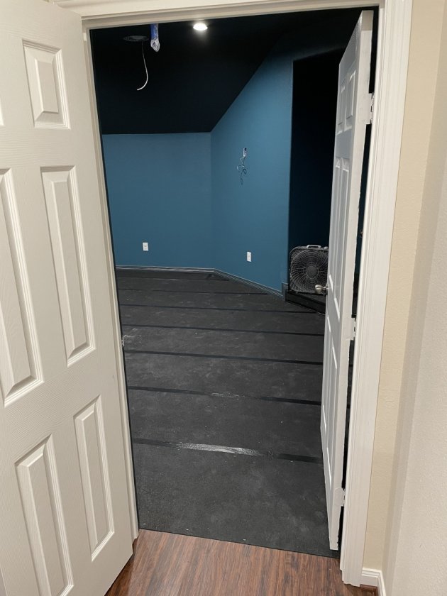

Interesting topic.   I actually stapled an entire layer off 6.4mm thick rubber vibration dampening material from AudiMute on the subfloor of the theater room.   It’s made from recycled tires, so it’s very inexpensive relative to other materials.   This worked really well.   You can barely hear any sound in the rooms below when the speakers are blaring.   I used some excess and cut it into strips to put under my X-Voce not only to separate it from the glass surface of the cabinet but also to tilt it up slightly (I may tilt it some more by adding more strips).
Now I’m wondering if it could be a substitute for all of the other things mentioned.
