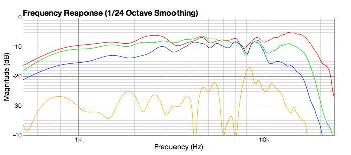

I had earlier been using a "naked" Neo3PDR. The on-axis FR always bothered me. I have since seen a similar effect in other measurements posted online. This is the measurement I took back then - as you can see, there is a fairly large dip around 8 kHz in the on-axis response (red line):
I finally got around to trying something else. It took a while of mucking about in Edge, but in the end I was able to get a fairly smooth response. Here is the measured response with the new baffle - purple is the tweeter with no EQ, green is with EQ:
There's still a dip at 8 kHz, but not much. The response extends lower and it's easy to EQ it flat. I haven't looked at the off-axis measurements yet. For all I know it could be a disaster out there.

Q. could the tweeter be placed at an angle to the listener to get the blue curve and then EQ from 10kHz to get the curve flat?
Sound a bit loud off axis though I suppose, I was thinking more to smooth out the 8kHz dip.

I'm not sure that would work so well as that is the 60 degree curve. The green one (in the first graph) is the 30-degree curve - that might be feasible... I'd never thought of that to be honest.
I'm not sure how audible the 8kHz dip is. But it's still annoying :)

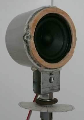

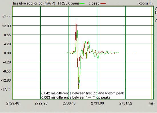

Is a non-circular baffle shape really "smearing" the response? I'm not sure I like the term, F and T are intimately related, as you know, ...
Maybe "smearing" is put too bluntly.  :oops: I will try to explain it more detailed in a later post. I'm still collecting the proper wording ... :)
... and a "perfect" dipole cannot have a "perfect" impulse response, fundamentally...
Thanks for bringing this up. I hadn't made up my mind about this well enough, but maybe I got it clear now:

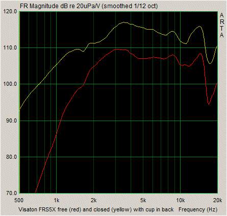

A perfect dipole has a perfect impulse response. If you compare with a "normal" driver in infinite baffle, you have to make the dipole separation infinite for a fair comparison. If the "normal" driver is boxed and the dipole is mounted on a baffle of the same size/shape as the box baffle, both will show the same diffraction pattern. Only difference: peaks and dips in the OB response have twice the SPL as for the boxed speaker.
The "imperfection" of a dipole impulse response in real life is a function of the bad/missing symmetry between front and back radiation. It is NOT fundamentally IMHO. Please compare these speakers:

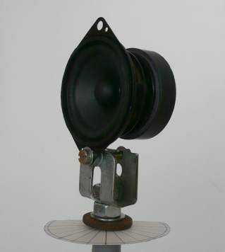

It is the same driver mounted without any baffle and closed with a cup to kill the back radiation. This are the impulse responses for both speakers. They are at the resolution limit of the measurement - I have no higher res. I have moved the responses slightly apart. Otherwise the green diagramm would be largely invisible:
The frequency response it not exactly the same, but similar enough for this comparison:
In the direct response we practically do NOT hear any separate delayed impulse from the rear of a dipole driver, but only the diffraction pattern of the baffle edges. I try to keep this diffraction pattern as uniform as possible 360° around the driver circumference - thereby keeping the resulting combined impulse response (of driver and baffle edge) as "original" as possible.

Here's my off-axis measurement of the new baffle.
(0, 30, 60, 90 degrees, no EQ)
With regard to "ideal" dipole behavior, before I was seeing that up to about 6k; with this one, it does that up to about 2.5k only. I'm not able to convince myself it's important... it still acts pretty much like a dipole but with a wider lobe....
Hi Rudolf, what I meant was that a "perfect" dipole has two peaks in the impulse response. This is fundamental. Otherwise, it would not be a dipole.

Rudolf, interesting but controversial (?) list. Is a non-circular baffle shape really "smearing" the response? I'm not sure I like the term, F and T are intimately related, as you know, and a "perfect" dipole cannot have a "perfect" impulse response, fundamentally...
Hi John,
it’s right to remember the first principles where dipoles start from. And your comments always come to the point. :) But in real life and for most of the frequency range dipoles are not two separated point sources, but a (point or expanded) source surrounded by a ring radiator – the baffle edge. JohnK has explained that in some depth in http://www.musicanddesign.com/Dipoles_and_open_baffles.html: In the 1/f-region (up to the first dipole peak) there is no second impulse for the equalized dipole (not even in an perfect dipole). If done right – making the baffle not too much larger than the radiating area of the driver – there will be no second impulse from the equalized dipole for higher frequencies either.
That said, in real life dipoles the prevention of the second peak in the impulse is not only desirable, but it is a prerequisite for a flat response. It is JohnK himself talking about “smearing” in this context:
“Third, while a larger baffle will increase the low frequency sensitivity the greater delay will translate a smearing of the impulse response over a longer period of time.”
I'm aware that above reads quite nit-picking. And it should not be looked at as "rules". But it is part of the understanding of a dipole. Whether the result (what result?) is worth the added effort and complication, is surely up to everybodies taste and demands.
