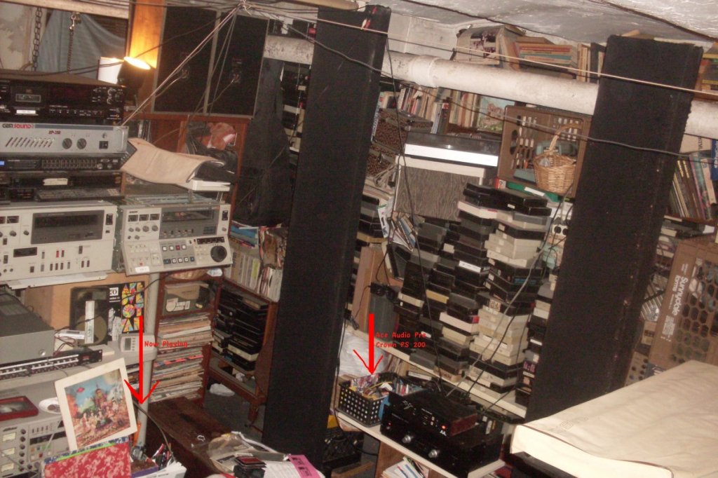

A friend of mine just scored a pair of 1+1's. I'm posting this so Satie no longer has to think that his listening room is messy.
