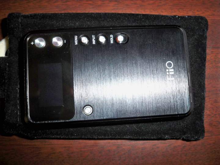

Thanks for the tip coke. There are a bunch of products like the iDo, I use a Fiio E17 myself. Fiio also makes a now outdated E7 and just about every manufacturer that plays in the portables ring has a product like these. Check out ibasso, and some others that escape me right at the moment, lots of nice units.....

My main goal was to bypass the Ipod DAC.  That's what made the iDo stand out to me.
It doesn't appear to be possible to bypass the Ipod DAC with the E17.  In the manual, they show using the L3 cable, but this just takes the analog signal from the ipod dock..

 Coke, If you use a LOD cable with an ipod your bypassing the DAC, I use one with the E17 so YES it does bypass the ipod DAC and its very easy to listen to for long, long sesions...I use it for Laptop USB DAC, ipod LOD cable to bypass ipod DAC, I even use it with my main system sometimes as the DAC, the E17 and most like it do these things as I'm sure yours probably does also....if your new to portables which sounds like the case you'll soon see there are so many great little devices... enjoy it!!!!
An LOD will only bypass the Ipod's volume control circuitry and internal opamp, and send that pre-amped post-DAC'd signal to whatever you have it hooked up to. It does sound better than using the headphone jack as an output, but not anywhere near as good as outputting a pure digital signal to an outboard DAC. A couple of devices will do this, one is the Wadia 170/1 dock, another is the Cambridge iD100, which I use with an AVA Vision EC DAC.

I stand corrected, sorry guys I was given wrong info it seems awhile back about the LOD cable......the Pure i20 is popping up all over and everyone seems to like them, I only use an ipod for walks and travel, the music all comes from one source which I play directly through my SB into my main system along with my Grant DAC and Virtue gear...and of course my JBL's.
