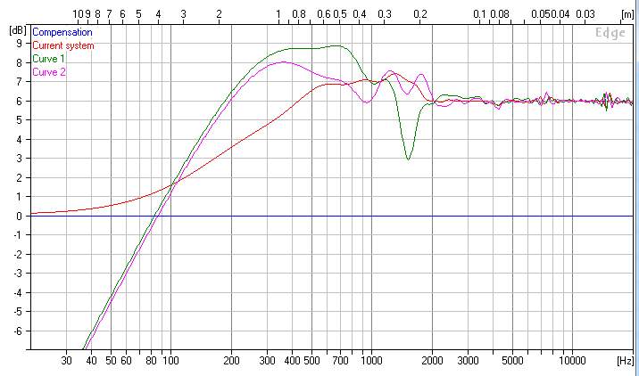

Do ob panel's all have 18db lowend rolloff?
Only below the woofer's Fs, however usually the panel dominates where the rolloff starts. You'd need to consider the highpass filter as well.
Here's some plots:
Green: 380mm W x 1200mm tall baffle, woofer at 600 mm and horizontal center.
Purple: same baffle but woofer offset horizontally... I forget how much but I think the center was 120mm from the edge.
Red: the response the crossover was designed for (closed box)
You'd get more bass with the second woofer - it looks like you would want to increase the inductor though (L5). It looks like you could cross them to the subs OK, although integrating well is a different story.
