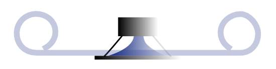

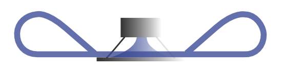

From what I understand, the area of the baffle with the pipe on it would be 18x18". The extra "thickness" due to the pipe won't appreciable affect the low-frequency response.
My suggestion for something to try would be to put the pipe so it only goes out the back... let's try...
Since you're using a full-range driver, the radiation at the back will get pretty chaotic above a couple of kHz anyway... or, here's another idea:

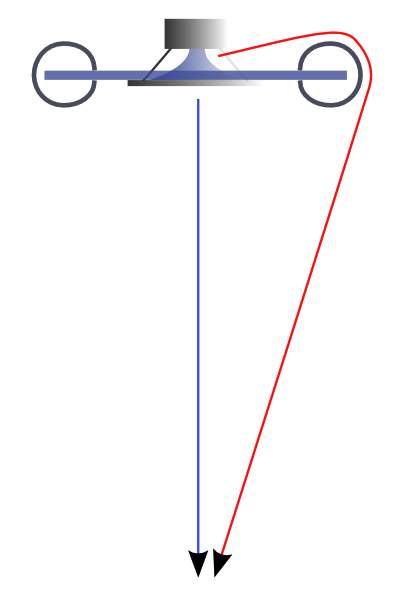

I think it will make a difference, but not as much as you are expecting. Here is (I believe) your proposal, with the front radiation in blue and the rear radiation in red. The difference between the two path lengths determines the amount of cancellation. I'd guess that the effective increase compared to not having the pipes would be about 2.5" - so effectively the baffle width would be about 22". Best way to find out would be to make a prototype and measure it ;)
