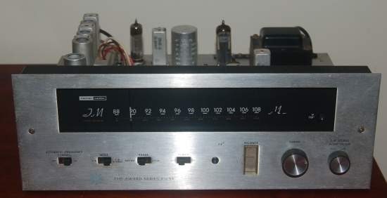

SteveFord
  • Posts: 6538
Re: FM is Fun Again,with Dynaco!!!!
« Reply #50 on: 4 Mar 2012, 10:44 pm »
FM is fun on Harman Kardon, too.
WTMD just played a Led Zeppling medley done by the band Those Darn Accordians off of the album "Lawnball".
Whole Lotta Love/Black Dog done on accordians with a female lead was pretty silly.
Here's a shot of the old bruiser:
As you may have guessed, this thing is built like a tank and weighs about as much as one, too.
