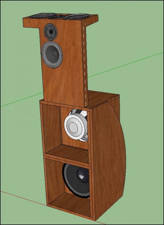

 After doing some more reading and playing with edge I have a possible design any input is welcome.

Yah there a bit strange. When I first thought about this design I wanted to try some of the tb high efficiency drivers but they jumped so high in price that I started looking at others and was interested in the W6-1721 when it went on sale 2 for $45 so i snagged them and after trying other drivers that i had kicking around I decided to try the other tb stuff because of the omni pole they needed to be a little higher efficiency to keep up with the front firing but this leads to a odd shaped top with it centered I was calling them t tops, but after fiddling around with them moving them over and lining up the tweeter and putting a small edge piece on the top really helps to solidify the imaging. If you ever feel the need to through out your tbs you can through them this way :lol:

They definitely look interesting unfortunately till money flies into my pocket ill start with this, it doesn't show on the picture but I was going to make a seperate baffle for the front an top baffle that slides over the h frame and this could easily be changed out later.

I think this is one of the easiest ways to separate the baffle completely from the subs.

The construction is a bit open for my taste. I like the "dipole airiness" carefully dosed.

I am not sure I understand "The construction is a bit open for my taste", the subs sit underneath this just keeps the two baffles separate to reduce resonance in the upper baffle.
I thought this was a pretty slick idea rather than magnet mounting the drivers to the upper baffle.
