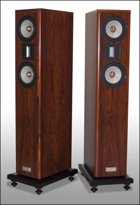

Here is a picture...

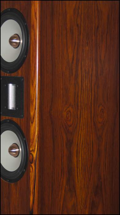

And a close-up...
I only wish I was a better photographer since these pictures do not do the speakers justice.  But that's life.

I was just searching for thoughts from Salk speaker owners and possible comparisons to Harbeth speakers. I happened upon this thread and sure enough these HT2-TLs are now residing in my system! When I saw "cocobolo" in the thread title it piqued my interest as that is the veneer on mine. Once I saw the pictures I knew right away. They still look amazing and sound incredible! Listening to Chet Baker's Chet APO SACD and it sounds excellent.
It's amazing to find this nine year old thread and it's significance :).
Edit: Looking at Jim's pictures the top one showing both speakers is a very accurate representation of the HT2-TLs. The color in the close up picture is a bit off. That picture shows the grain with a "yellow" tint. The veneer is more towards a red shade than the yellow of the picture.
