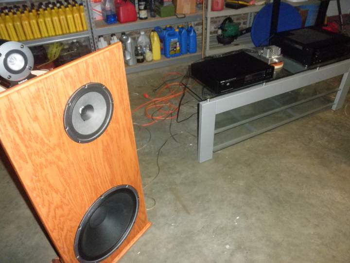

My Miniwatt worked great with my Zu Omens, Tektons, and Frugal Horns. I now have it driving DIY Wild Burro Betsy's over SS powered Alpha 15A's in open baffles. There may be a picture of this combo in my gallery.

To the right is the little silver Miniwatt driving the Open Baffle Betsy mains and super tweeters
