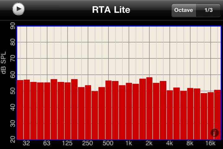

It uses a microphone. http://www.studiosixdigital.com/rta.html - "RTA ... uses either the built-in mic, the headset mic, or the Studio Six Digital iAudioInterface microphone." Play pink noise through the speakers (equal energy over bandwidth) to get the FR of the speakers/room.

Yes, but so is doing multiple measurements ;) As a practical matter, all you need to do is a "constellation" of locations over your defined listening area. With some masking tape and a tape measure, it only takes a few seconds to redo each sweep.

IK Multimedia ARC system does similar corrections. It takes up to 32 measurements in different places in the room then shows you the response results (and creates an EQ plugin to correct the response). My EQ response with it has been lackluster, but it does give you a good idea of what your speaker is doing in the room. Of course you could also use ARC, fuzzmeasure and fabfilter Pro-Q and do various tests and corrections that way. Compare listening position results to ARC results and correct from there using fabfilter.
It doesn't really tell you where to position your speakers, but it can help you adjust for where they are currently. It'll never replace a well treated room especially because DSP tends to have its own plusses and minuses, but it's an option.
Though perhaps this is a post setup tool rather than a setup tool. There are lots of rules of thumb regarding setup, it might be better to start with a commonly accepted benchmark, adjust it by ear, then correct it by RTA Mic. It'll be a while before there's a simple plug and play room setup solution like with Pre/pros and their room correction features.

It should be mentioned that the RTA Lite app is a little dodgey when it comes to getting the exact same measurement twice. See my gallery for examples of this. I have uploaded three measurements made at the same location,ear level at the listening position, and I have three slightly different measurements. It looks like I would have a little better accuracy if I was able to take multiple measurements and then average the graphs. From what I can see this will show a more consistent trend to the response curve then just a snapshot in time.
