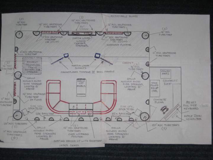

Getting great acoustics requires many bass and midrange traps that have reflective
membranes (this prevents the room from being to dead at high frequencies)
I have ASC tube traps and GIK bass traps and the entire ceiling acts as a membrane
absorber for lower frequencies.    All these traps are placed uniformly around the
entire perimeter of the room which gives one a very consistent sound field.    One
can walk around the room and get the feeling of great space.   The final result of all
of this is transparency and great voice reproduction (intelligibility).      No digital
equalization is required and the less electronics one has the lower the noise floor.
Here is a diagram of the room that I use with my loudspeakers.
