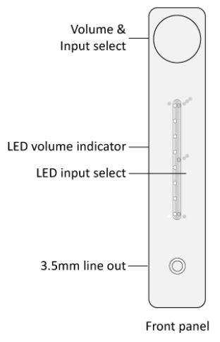

The specs of the Dia say there's a separate line out for a sub but I'm not seeing it in the pictures.  Using it that way would also then still force the small mains to run full range.
The Dia references a line out to be used for a subwoofer, but the only line out seems to be the 3.5mm line out on the FRONT panel, which seems a bit wonky.
