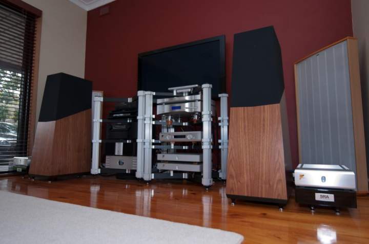

Here is my current 5A setup:
darthlaker
Re: Amps Being Used with Vandersteen 5As
« Reply #10 on: 30 Dec 2011, 01:04 pm »
VERY nice!
Love the 5A's in black as well.....
Not sure if I would change your amps...I am sure they do the job just fine...
