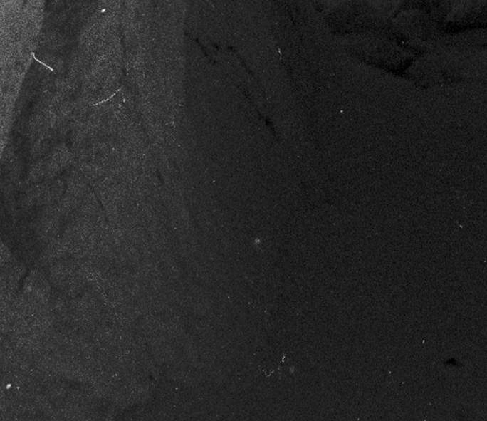

Photon46, when I scanned my 4x5 film, I aimed to be able to produce a 16x20 end product at >300dpi resolution although I have seldom ever printed larger than 11x14. Does that sound reasonable? (I can definitely confirm what you say about dust etc; even though I used a Kostiner anti-static brush, I still spent a *lot* of time in post with the Heal tool.)
If I need a scan good for a 16x20 @ 300 dpi, I take the length of the image (twenty inches) and divide by the corresponding film dimension (five inches) and get a multiplier of four. If I scan @ 1200 dpi, I can enlarge it four times and then have a 300 dpi image.
The bottom pic is a 100% detail from an 11x14" scan @ 600 dpi. You can see all the crap you've got to cleanup in a hi rez scan. This is from a 4"x5" Tri-X negative developed in Pyro developer. It was shot at Great White Sand Dunes and wind blew a lot of dust into the camera that day. I use my scans for making copper plate photogravures, so I need really high resolution scans to make gravure films. I really like the Kostiner brush as well.
