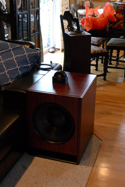

Just thought I'd post a final picture of my LS6 build.  It's a bit cluttered with Christmas right now, and the tree is not helping with the soundstage, but you get the idea.
These are the MFW-15 subs and x-omnis as rear surrounds:
