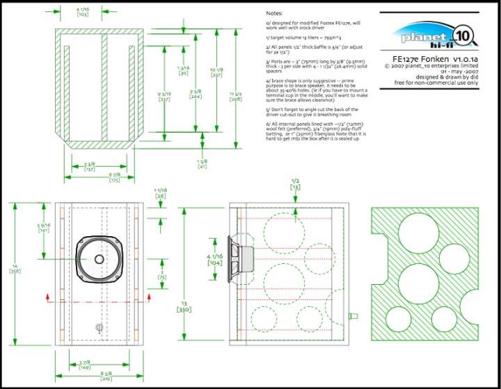

John -  absent access to FE127E (stock or otherwise), and if you're inclined to try another Fostex driver , also known to work well in this format of enclosure are the new FF125WK, and the less budget oriented FX120.
Note that Dave's design goal with this format won't deliver the same performance in the lowest octaves with same weight class drivers that you're hearing with the FH3/126, and that the F-en enclosure volume and port dimensions are carefully tuned to each driver model's measured T/S parameters (in other words, drop in replacement of the 125WK in the drawing above won't give the smoothest results).

Somewhat out of date, but you'll get the idea... http://www.diyaudio.com/forums/planet-10-hifi/160747-fonken-style-box-nomenclature-what-those-names.html
A Fonken requires a Fostex driver (for the F). Generically they are officially called miniOnkens (or less officially, Fonken-style).
When Chris 1st coined the tern Fonken, we had no idea how widespread in application the basic concepts of this design would turn out, and what a struggle we'd have to name them all.
Each enclosure is very tightly tuned to the specific drivers that go into them, willy nilly driver substitution will not give the best results. The goal is not for maximum LF extention, but a finessed bottom end that does not sacrifice upperbass or any midrange. These recognize that for a true 10 octave speaker, help is needed and our recommedation there is to add a pair of helperWoofers. Also part of the philosophy is that in any speaker one should be able to enjoy the music while playing just the "midrange", in the current context meaning your pai rof miniOnken.
I am currently working thru the set of drawings for the FF125wk, a driver that is going to be right up with EL70eN & Alpair7.3eN in the 4" class. The boxes will have the same shell as the current deciSize boxes for the MarkAudios, so will be called dFonken125. They will come out of the gate with regular (medium build difficulty), CGR (Classic Golden Ratio -- easiest build), and the new Trapezoid variations (for those very comfortable with wood-working). The basic CGR plans will be published (free for diy use), the much more comprehebsive planset subscription will cost a nominal amount.
