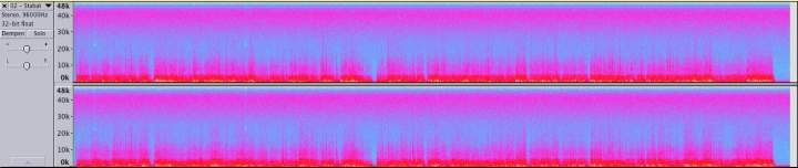

« Reply #10 on: 4 Dec 2011, 10:42 pm »
otah,
Audacity analysis
of this fine Tallis Scholars 24b/96hz recording of Palestrina's Stabat Mater http://www.gimell.com/recording-Allegri-Miserere-Palestrina-Missa-Papae-Marcelli.aspx looks rather polluted, but sounds terribly fine. Or is the top pink display the "Ambiance", and just as it should be?

« Reply #11 on: 4 Dec 2011, 10:51 pm »
Yes, that looks to me like an SACD rip.  It has good energy way beyond redbook (22k) and then looks like DSD-induced noise shaping above 30k to 48k (96k's max).  Frankly, all that really matters is how you like it, but I assume it sounds good.

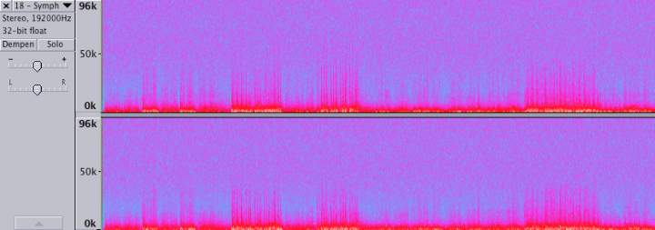

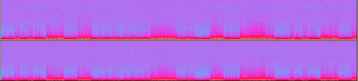

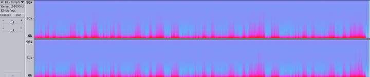

« Reply #13 on: 4 Dec 2011, 11:57 pm »
what about this one then, which does not sound very nice. Distorted is the wrong word, but very metalical, some might even say Digital... :scratch:
Mozart Symfonies Paris, Hafner, Linz on Linn Records 24/192 http://www.linnrecords.com/recording-mozart-symphonies-29--31--paris---32--35--haffner----36--linz-.aspx
closer look:

« Reply #14 on: 5 Dec 2011, 12:16 am »
I can't ell real well from the resolution of the screen capture but it looks like a good 24/96 recording (some good energy to 48k) that doesn't reallly take much advantage of 24/192...but who knows, some DACs sound better at 24/192.  You need to show the spectrum analysis too.  Simply, once this is done, go up to top level menu and go to analyze, and pick "plot spectrum".  Choose Blackman Harris and 8192 as size.  This shows energy over time (usually about 50 seconds of hirez only, which is fine)
The example above shows a Patricia Barber SACD that I ripped and converted.  When i first made this screenshot I mislabeled it as redbook brickwalling, which it really isn't.  I found out the original was done as 24/48k then transferred to SACD.  Hence there is no real brickwall (flat line of cuttoff red spikes at 22k which would say "redbook") but nothing great either, more like a pretty good brickwall at 24k...but at least the original was 24 bit (something we don;t know from these graphs..I learned it later that the tapes were trasnferred at 24/48).  The recording is very nice, but not worthy of hirez, at least the way its transferred here.  I can now listen to native DSD and that version (no PCM conversion) is a lot nicer.   The Purple and white graph is the spectrum plot.

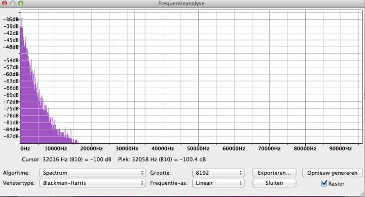

« Reply #15 on: 5 Dec 2011, 08:24 am »
Thanks Ted, here is the Bachman Harris, but the 8192 size is not in the options, 4096 is max.
This is what the Frequency analysis looks like:
Bachman Harris 8192 selected.

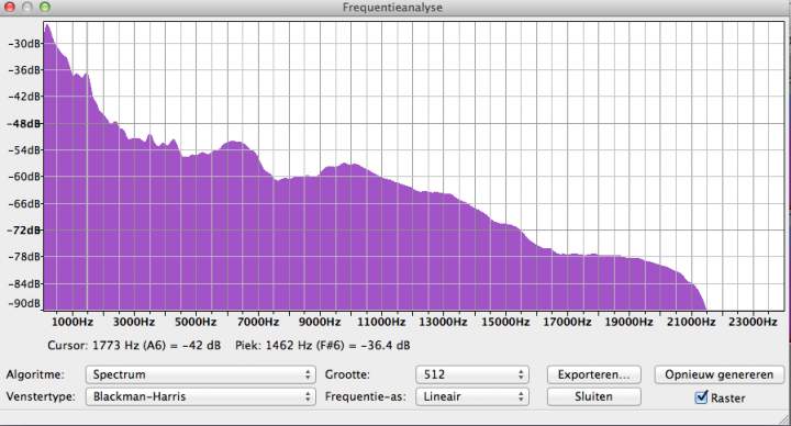

« Reply #16 on: 23 Dec 2011, 09:47 am »
New SoS 24 bit flac download of The Wilderness of Manitoba, When You Left the Fire-FLAC24
and
this the infamous red book brick wall?
