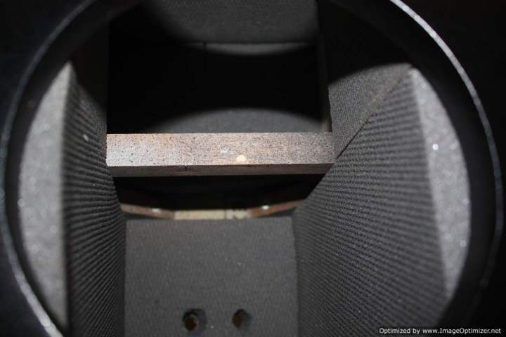

I've done the Norez but fell short for a couple of spots. To be precise
1. A 5" X 5" spot just behind the tweeter on the top baffle. Hope the below pic helps.
2. And part of the side wall on either side, after the Brace A in the middle. Pic below.
First, Are these critical areas that do need the damping sheets or can I leave it as it is and just fill the cabinets with polyfill and be done with it?
If it does make a considerable difference, shall I just fill the above space with carpet underlay or 1/2" foam sheet around the same density of NoRez
Please do suggest.
thanks
Danny Richie
Re: N2X Build
« Reply #3 on: 26 Nov 2011, 05:58 pm »
You don't have to cover every square inch of space.
I can't tell from the pic but you'll want to come back off of the woofer just a little so the woofer isn't forced to work through the foam. Coming back about an inch or so off the front baffle on either side of the woofer works fine.
The No Rez is really dampening the resonances of the panel that you are putting it on. So even a piece of it in the middle of the panel is effective. The center of each panel and away from the braces are where it can be the most resonant. Those are the areas of attention.
I think you have it cover.
Lastly, add a loose fill of poly fill or fiberglass insulation right behind the woofer and cover any area where there is no No Rez and your good.
