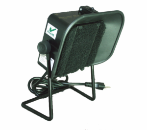

Bench-Top ESD Safe Smoke Absorber
http://www.circuitspecialists.com/bk486.html
This one, at $28, is certainly Cheap and Cheerful.  Although Edsyn says their Atmoscope Fuminator's rotating filter is 8 times more effective than a stationary filter, neither gives any specs on particulate removal.
http://www.sentryair.com/products.htm
Sentry Air Systems smallest benchtop model, the SS-100-SS gives filter specs (99.97% efficient on particles 0.3 microns and larger with HEPA filter, 95% efficient on particles 0.5 microns and larger with ASHRAE filter).  Although this one seems very serious, you have to request a quote for price, so I would imagine it is expensive !
Steve
