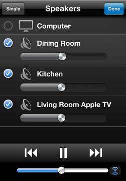

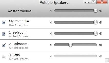

When an Apple TV or Airport Express joins the network, the Multiple Speakers dialog in iTunes on your computer will allow you to select which remote devices are active.
An Airplay Speakers dialog will be available in the iPhone Remote app to also select these device locations.
And finally, a similar dialog will also be available in the iTunes app on the iPhone and various other iPhone apps to stream content that is stored on the iPhone or being streamed from the Internet to the iPhone, and then to selected locations.
Steve
