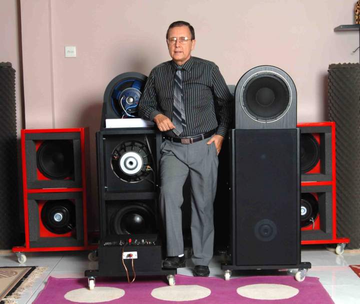

Hi all Audio Circle members.
I have built a (Modified) V2 sub section.
(The drivers are not set at an angle, therfore, the enclosures are wider, larger.
You can see them in the back. (The red ones.)
The bass sound is very, very good.
Very nice Guy. I'd like to hear that set-up!

I just have one 15 inch woofer in an h frame with the sa1 amp.  Sounds great to me...
Danny Richie
Re: Has anyone built just the OB sub section of the V2?
« Reply #6 on: 21 Nov 2011, 02:35 pm »
There's some interesting stuff regarding 8" servos in the New Info thread where I asked this; Would this not work:
You need to separate the front wave from the back wave a little bit to get any output from it. So you either need a wide baffle or an H or W frame to create that separation. Enclosing the driver some with a H or W frame also loads the driver a little and helps with control and extension. It also helps keep a narrow profile for drivers above. Side panels also give you the support that you need to hold the baffle still.
In the panel that you drew it will have only slightly more output than holding the driver in your hand while playing.
