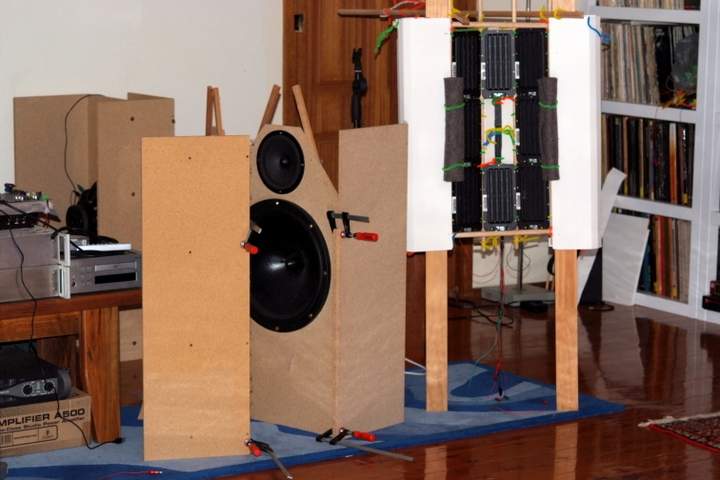

See pictures below for two planar tweeters surrounded by 8 planar mid drivers. This is an arrangement inspired by the talk about coax "point source" drivers. You will never get a point source with a large planar driver, of course, but since I had been wrestling for some time with the idea of an array of tweeters above an array of mids, I decided to try this type of arrangement out instead. I also was inspired by a discussion with Paul Spencer on his DIY Synergy Horn. The end result is what I was able to come up with that gave the smoothest on- and off-axis response.
Anyway, here are pictures of the prototype. Front:
Rear:

Quick pic of the woofer module prototype, to go underneath the planars. Nothing specific to report audibly/measurements-wise at this point, although it looks promising.
