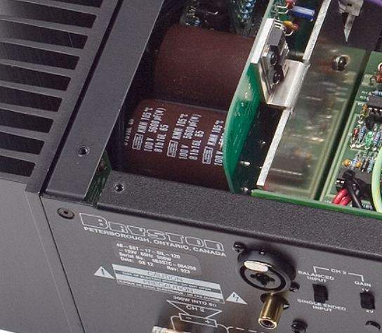

Is there anyone here can confirm the ratings of the Caps in 4BSST2??  :scratch:
srb
Here is a photo of a 4BSST2 4BSST showing one of the 5600uF 100V 105°C power supply capacitors.
Steve
« Last Edit: 10 Jul 2011, 11:39 pm by srb »
vegasdave
  • Posts: 4038
I hate to say this, but the sticker says SST not SST2. But, they're probably the same caps, true?
srb
I had found two pics of amps that were supposedly "squared" models, and neither has the squared nomenclature on the sticker, so maybe it isn't.  Or perhaps it is reflected somewhere in the other numbers?  Maybe someone with a "squared" can take a look at their rear panel sticker?
At any rate, I would be surprised to find any semi-recent Bryston amp that didn't have 105°C caps.  If I'm looking at an amplifier and have the ability to look inside, I probably wouldn't buy it if it had 85°C caps.  Given the same operating enviornment, they're just not going to be as long lasting as the higher temperature spec caps.
Remember, the caps will gradually degrade over time, and you might not notice the slow decline in sound quality over a long period.  That's why many people who have re-capped older but still "working" amps often have a relevatory OMG at the improved sound and dynamics.
Steve
