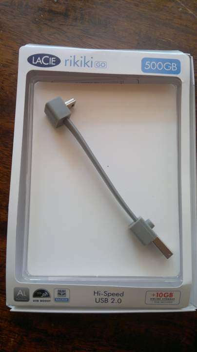

ok, will have to buy one cause no Y cable laying around
this is the cable that came with the HDD. Anyone know if that's something special? I'm not using that one because it is way to short, but I had hoped that to be of no consequence?

To find out if you have a power issue with that drive you could pick up a USB Y-cable which would enable you to attach your drive to two of the BDP-1 USB ports which would double the power available to the drive.
