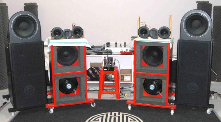

I did additional listening and evaluation of my GR Research V1, V2 and N3.
I am using my N3 without any enclosure, because I am waiting for some money to come in from my home country Canada and then I will be able to give Ruben (Fallen Enclosures) an order to build a N3TL enclosure for me.
Here are my impressions of my set up, after a few hours of listening with various types of music covering the full spectrum of frequencies. (20 to 20Khz.)
I don’t want to say that the V1 is still the winner, because I prefer to say that each speaker has its own strong and weak points and each enclosure as its own tonal timber.

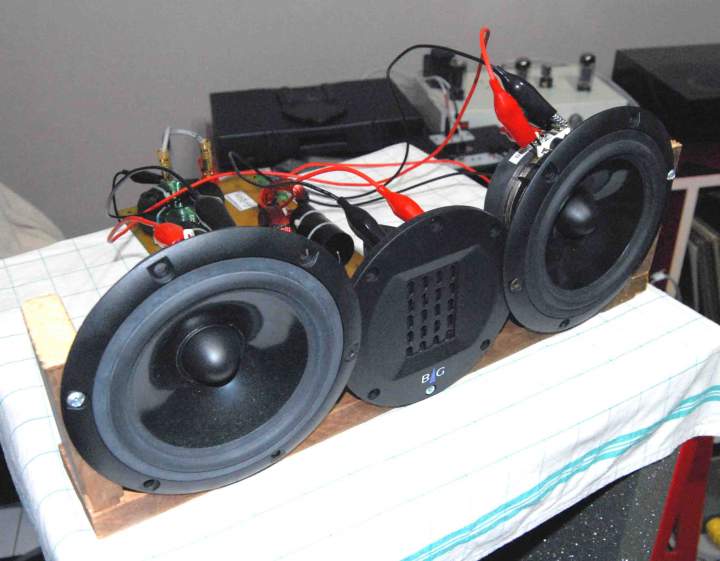

Beyond using the N3 drivers boxless and baffleless (which is enough in itself), the 6 mounting holes on the woofers and the 8 mounting holes on the tweeter are there for a reason - to keep the driver themselves from moving.  By using only one mounting screw, they are just "flapping in the breeze".
I understand this is a temporary setup, but how can you make any kinds of comparisons with other speakers?

not to mention that as a L+R i believe the N3 is designed to be vertical, and not horizontal. but it does give me the idea of building an N3 with 1/2" clear acrylic :green:

Wow, I thought the holes all around the drivers were there for decoration or maybe to poke some flashing LED in the holes to focus your eyes on the drivers. (LOL)
Flapping in the breeze, as you wrote, to me is a little exagerated...
I know that if I secure the drivers with all the necessary screws it will improve the sound and the performances of the drivers, but that was not the idea behind this project, evaluation, funny experimentation...
This set up is not even temporary, it only a one day set-up, as I write this topic, the N3 drivers are back in their boxes waiting patiently for me to get some money to be sent to Rubben...
With this set up, I cannot make a serious comparasion, but it's only to have fun and to have a slight idea of what to expect.

makes me thing that you still don't have the servo subs hooked up correctly. They will play considerably lower than the woofers in the V-2 and have at least twice as much impact if not three times the impact capability.
So I am not sure those are either hooked up properly or not working properly.
Plus those wheels could be allowing nearly half the output to be gone at some frequency ranges. And that could be what is eating up some of the bass.
And playing the N3's like that will give you a 4 or 5db peak near 1kHz that might sound terribly bright.

When I move all my speakers in my acoustically treated listening room of our new castle, I will install the heavy duty spikes.
That should solve one weakness of my V1 and V2.

I was wondering if I could mount the two servo drivers the same way, not in opposit direction ? That might make the wiring simpler for me.

H212S and H212E.
(H = H Frame, S = Servo, E = Eminence, 212 = 2 X 12")
Amateurish you say ! My V1 are built according to the book, the only difference is the wood cosmetic.
The basic of the V1 is not different from Danny's original design,
it's even better, because I have at many places doubble wood thichness.
As for the N3, it's only a test I wanted to do, is there an Audio Law against that?
You guys are way to serious about this hobby, you are almost fanatics and extremists.
Excuse my rude words, but that's what I think and again, is there an Audio law against writing what we think?
Therefore, until I have my acousticaly treated audio listening room toward the end of this year, I will have fun with my version of the GR Research V1 and V2 called Guy 13 model H212S and H212E OB speakers and please don't spoil my fun, please... Try to be more understanding and friendly like Danny. Mr. Danny is a gentlemen when it comes to sharing his opinion with me.
By the way, I am not complaining about the performances of my GR Research speakers, I am only sharing my thoughts and experiences with the Audio Circle members, can't you see that ?
Have a nice day Mr. Clark.
