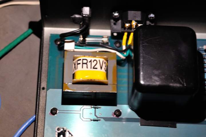

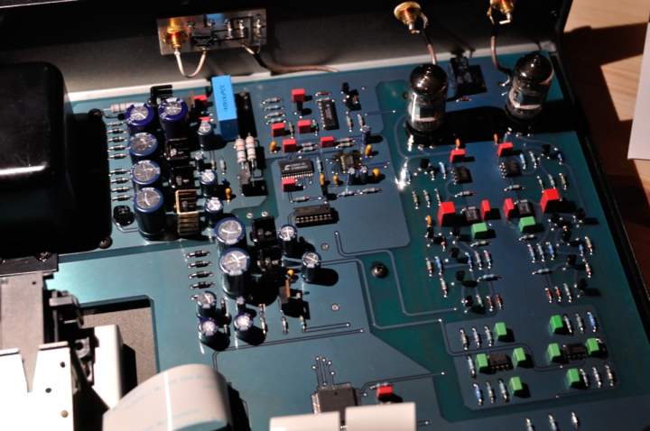

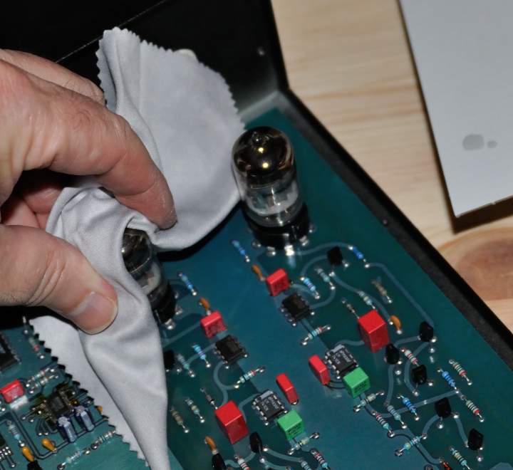

CD-1 (QDS-15) motherboard with the output tubes

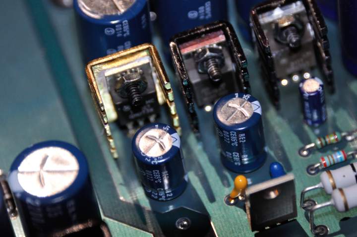

the power section
remove tubes

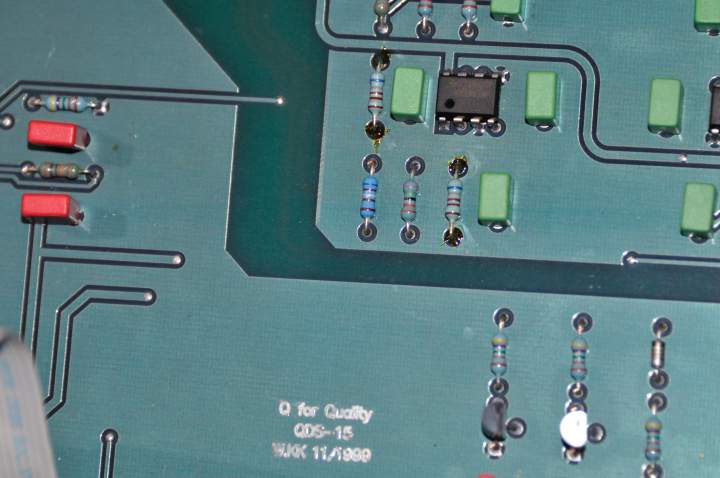

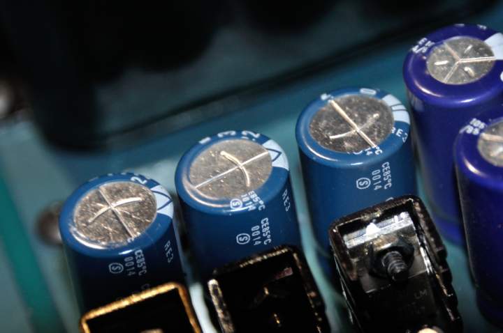

old tube on right new tube on left

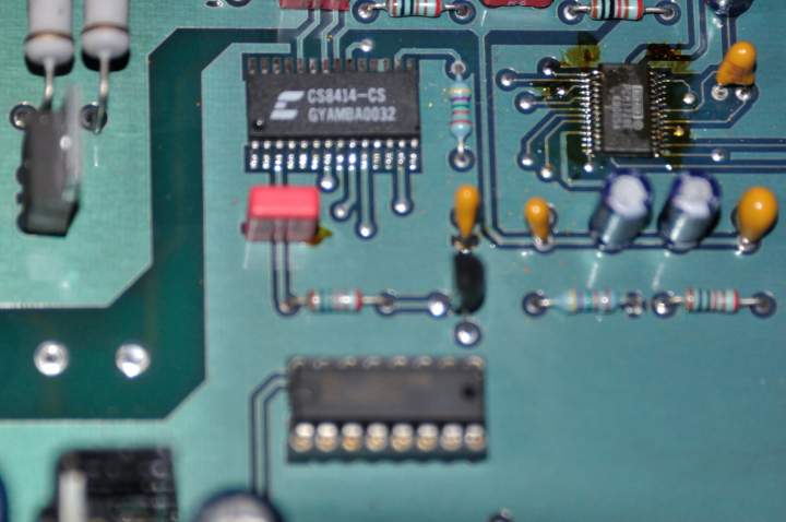

Is this a problem?

Is this a problem?
It doesn't look great but could just be a botchy repair/rework job. What's the number on the chip?

I will have to get a better shot of the chips - I thought for sure i would have some in focus - need to take the chassis apart again tonight

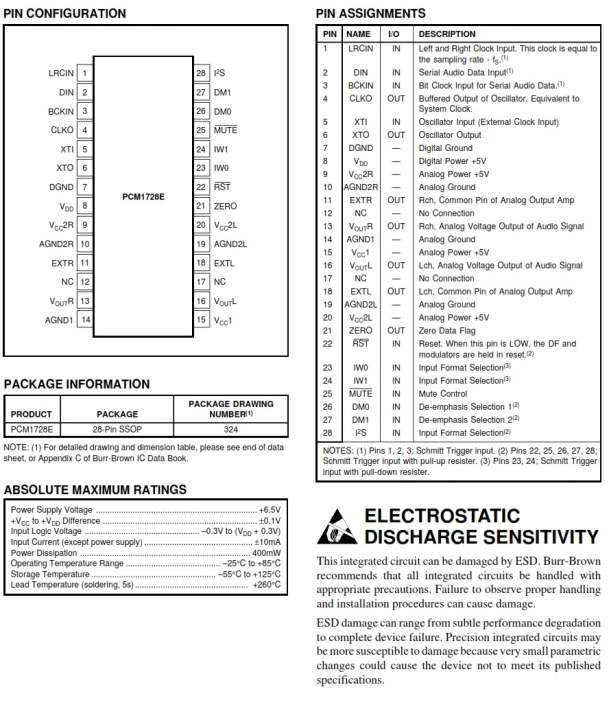

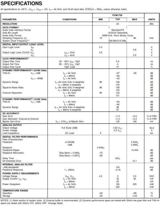

It appears to be [ PCM1728E K9005A ]
... whic his a Texas Instruments DAC
   Audio D/A Converter ICs 24-Bit 96kHz Smplg CMOS D-S Stereo DAC
... and you can read the rest here
http://www.ti.com/lit/ds/symlink/pcm1728.pdf

Looks like flux. Is it still "frying bacon"?
