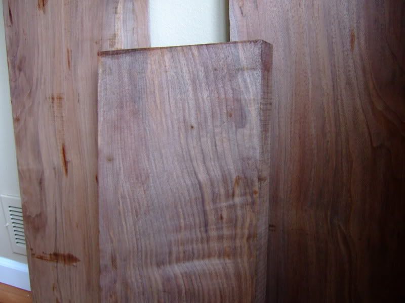

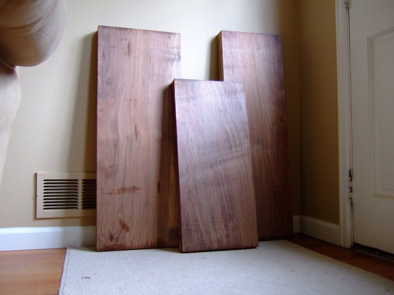

I found some nice lumber on ebay, air dried claro walnut, 2 1/4" thick. They will be shelves for an equipment rack, and I will have a total of 4 boards (one more is on the way). The question is how to support the shelves. I can work with wood or metal, but this has got to be quick, easy, and look good
. Total width of the shelves will be about 26.5" after they get trimmed and finished.

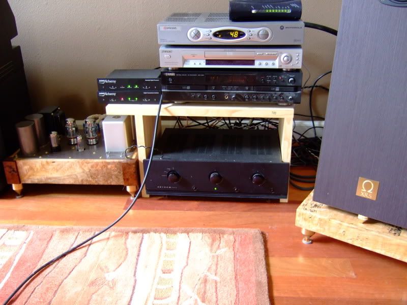

Right now I'm thinking the amp on top (better heat dissipation), preamp under the amp, and sources on the lower shelves. Then there's the cable box, the audio alchemy DAC setup, and the tube-rectified power supply box for the preamp that I really have no idea what to do with.
I may need more shelves, or maybe resaw one of the shelves into 2 thinner ones...
