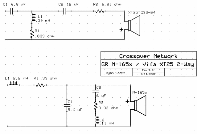

« Reply #14 on: 12 Jul 2007, 04:21 am »
Crossover is final!  I needed a break from the OB2X which is driving me nuts, so spent all day today finishing up the details for this project.  I made a few more changes to the network today based on listening and measurements.  After I decided on final values, assembled the boards and buttoned it all up.
I really have to say, these speakers sound incredible.  I'll hold off on the adjectives until I have somebody else listen to them, but my initial impression is simply stunning.  Fast, articulate, musical, with a very deep and wide stage.  They have a presentation that instantly draws you in.  Being familiar with the drivers prior, I honestly didn't expect results this good ... but I got 'em anyway!  3db down point should be around 53hz in a sealed box, so not tons of bass but what is there is clean and full.  As you can see in the pictures, I used all high-end components, ClarityCap SA and AudioCap Theta caps, Goertz Foil inductors - except for tweeter because I didn't have the right value foil, North Creek resistors.  I'm awfully proud of how I assembled the boards too :)
Just FYI, this schematic is after probably 30 revisions, definately not a whatever looks good in the crossover simulator only final design.
