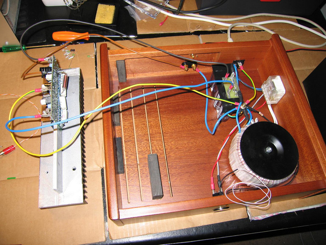

Here is a pic of my desktop :
http://www.audiocircle.com/image.php?id=3446

Here is a pic of the damned thing !! I'll never turn it on again !!
http://www.audiocircle.com/image.php?id=3447
