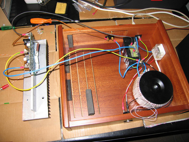

Here is a pic of my desktop :
http://www.audiocircle.com/image.php?id=3446
Hope someone can help
Thanks a lot

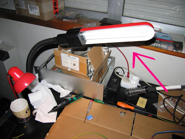

When i was playing music through it, the amp was fine, after the bump the HUM went crazy. Thats because when i bumped...i didnt just bumped the CD player...i bumped the entire workbench. What was on the workbench you might ask ? My working light !
A horrible fluorescent lamp, that introduces HUM like hell into the power line. This was the source of the HUM. Lights off....no hum !!
What a HUGE difference....
So Greg...my amp didnt have the zobel yet...i am gonna put it now. I'll bet this will make a difference in my case. Did you have a lamp like this in your line when you were testing it ?? My guess is that you did.
1 thing Engineering school has taught me....everything happens for a reason...i couldt settle with just a "divine chance" guess.
Cheers !!!
Here is a pic of the damned thing !! I'll never turn it on again !!  :lol:

Felipe,
I'm so relieved   :lol: .......  I had thought there was an amp problem!!
Fluoros can be a major source of hum.  They have UV emissions at audio frequencies.  And with the plastic covers, there is no EM screening around the ballast or electronic limiter, either.
